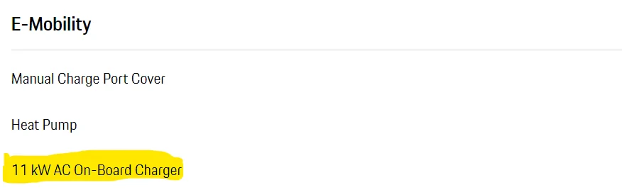

So is it any way to charge at home at 22kWh?
533
906
Electric Macan EV AC maximum charging power Screenshot 2024-08-01 093502
It's a car limit so you can't do anything to change this factory spec
