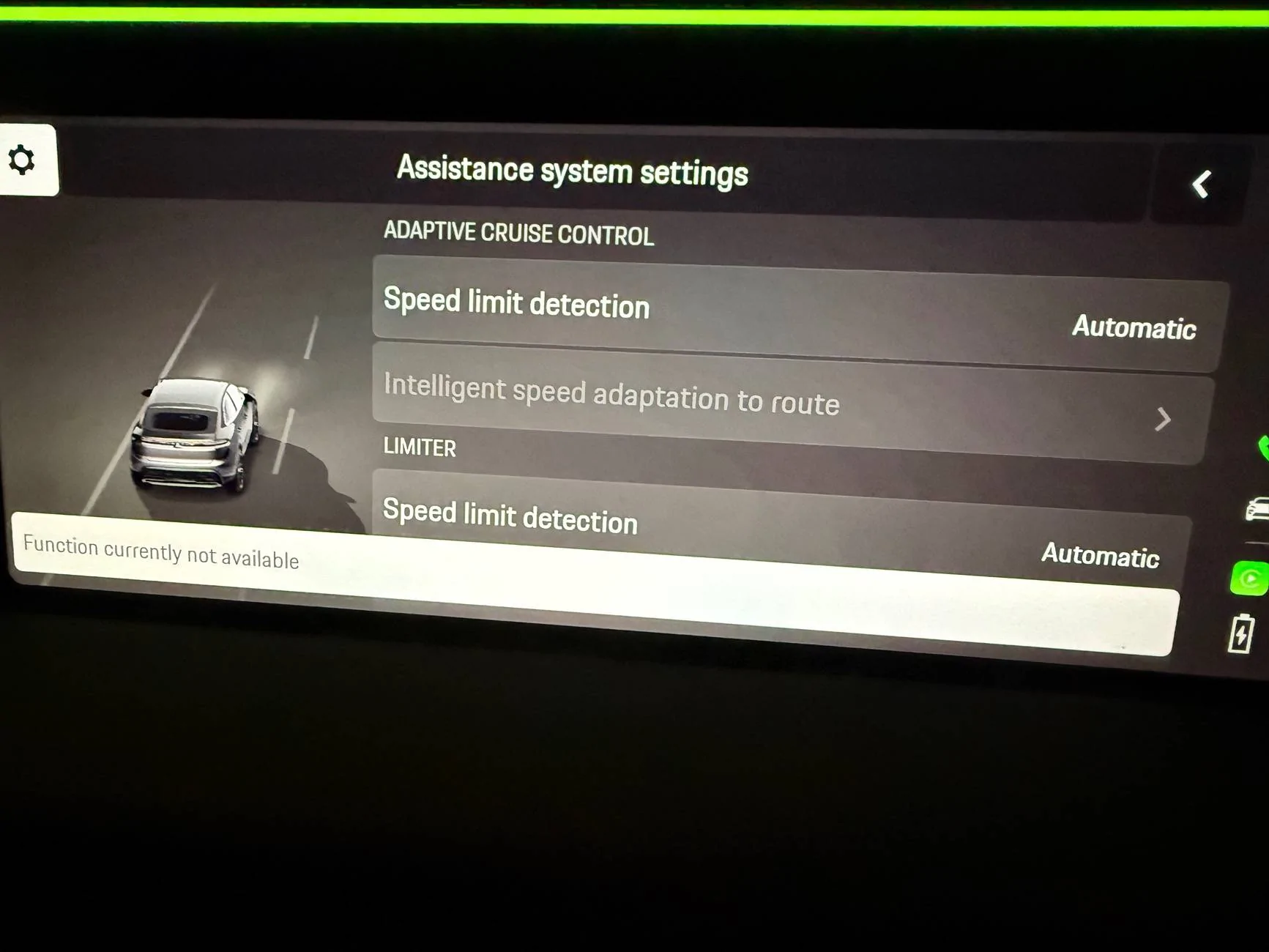

Hi
Issue has been solved !
-Go to the home screen
-Select Car
-Top screen – Select Assistance
-Top left select settings
-Select assistance systems settings
-Speed limit detection set to ‘Automatic’
All good
Happy driving!
Have you got personal experience that’s it’s fully working? I’ve changed the setting, and will give it a try tomorrow then report back, but it’s still saying that functions aren’t available, including the route topography automation.
It’s been my one frustration with what has otherwise been a great car, as it worked so well on my Audi e-tron - camera recognition, speed adaptation, lane assist, automated adaptation to topography… so as Porsche and Audi are part of the same group, and both cars are of a similar build quality/luxury brand, it bugs me that they can’t take something that’s worked for the past 4 years on the Audi and just pop it into a very similar Porsche. Hey ho!
Hi, yes it’s working. I drove to France and back to Uk. Only issue i found is the car will sometimes recognise the speed signs from the side deceleration exiting roads and then will slow down which could be potentially dangerous….
