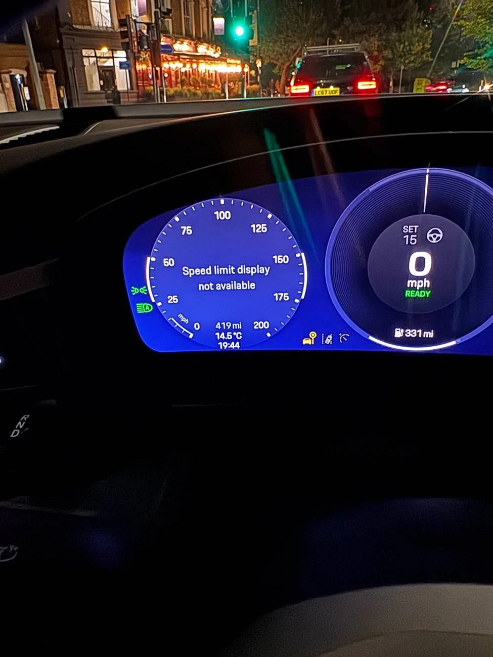

Assistance Systems Error - Speed Limit Display (warning message)

Picked my Macan up yesterday and I have the same problem. The speed limit function switches off at exactly the same place on road, about 2.5km (as the crow flies from my house). It switches back on at the same place. To test a theory I drove away from my home in a different direction and again it turned off after 2.5km. Could this problem by related to a geo fence which has been set up in the tracking software.

Car has been with Porsche Garage for 4 days. They have done a reset and recalibration of the innodrive but the Assistance system error persist sporadically. They are waiting further instructions from Porsche Germany but they are now saying it is likely just to be a software issue which could be fixed with an update… Still waiting for more info. Now they canā€˜t release the car until Porsche Germany agree it is safe …..

I have an update from Porsche Germany. Since they have my car for 7 days, they have apparently rewritten parts of the assistance system software and will upload / test it tomorrow. It’s likely to be an update for all other cars with the same problem

Pfff :mad: . I was told the error message was fixed but it hasn’t !. I can see they’ve done a full system reset. Initially, I had no fault but about after 10 minutes driving everything is back again !!!!!! Don’t know what to do. I’m so disappointed

Just thought I’d drop this note in for some who are wanting to get some more detailed info on this problem.
Yes it’s Software-Based, not Hardware.
Sensor functions are not the issue, it’s the communication networking between all of the systems that is looking most likely.
It’s also down to the car thinking it’s in a different locale/GPS area in which Porsche do not provide assistance systems (can’t confirm exact location).
As the car runs Android Automotive OS, everything is compartmentalised, meaning the location error is only specific (at present) to the process that runs the assistance systems networking, not Navigation, Car Finder processes etc.
A Factory Reset (in the PCM) and re-attaching the MyPorsche Account will fix it for a short period (shutting off the vehicle and locking in between Reset and re-attaching). However will likely raise the issue again within 15 minutes or so once systems start coming back online and carrying out their checks.
IIRC VW had similar problems with the early software builds of their vehicles from 2020 onwards.
Can’t give any more than this at present, but will see if anything arises in the coming weeks.
Will be interesting to hear if anyone else has any more info following on from diagnosis of theirs at a local OPC.
I Steve, i left my car for nearly 2 weeks at the London West branch. They done a reset but all errors are back again after 15 minutes drive. I am so angry they didn’t fix this issue. How did you know about it ? Is there any update?
