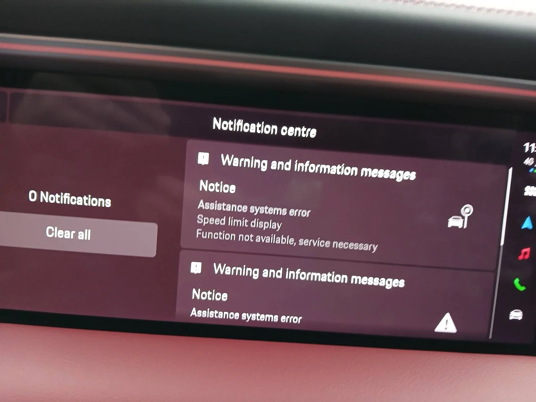

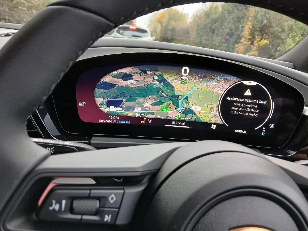

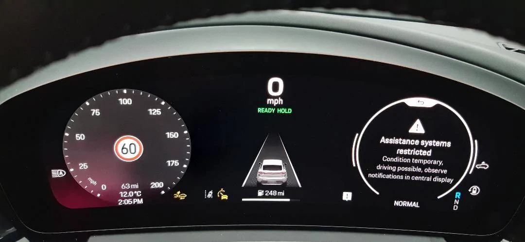

One day into ownership and have the traffic sign recognition fault (which is clearly intermittent but more off than on). The adaptive cruise control functions are the same, keeps coming back with messages that the feature is wholly unavailable and can’t be initiated and later works. Also getting intermittent errors giving an ‘assisted driving’ warning light and a ‘warn and brake assist’ warning light. That’s it so far.
Dealer claims were unaware of issues and had no problem with their demonstrators (none with Innodrive). However, did say another 4 with Innodrive collected the same day as mine has similar issues.
Will have to see what happens once one of the dealers technicians goes on a course next week!
