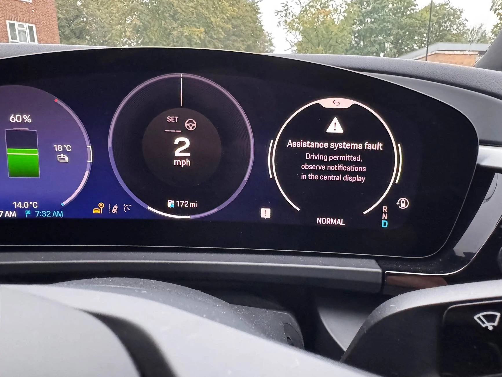

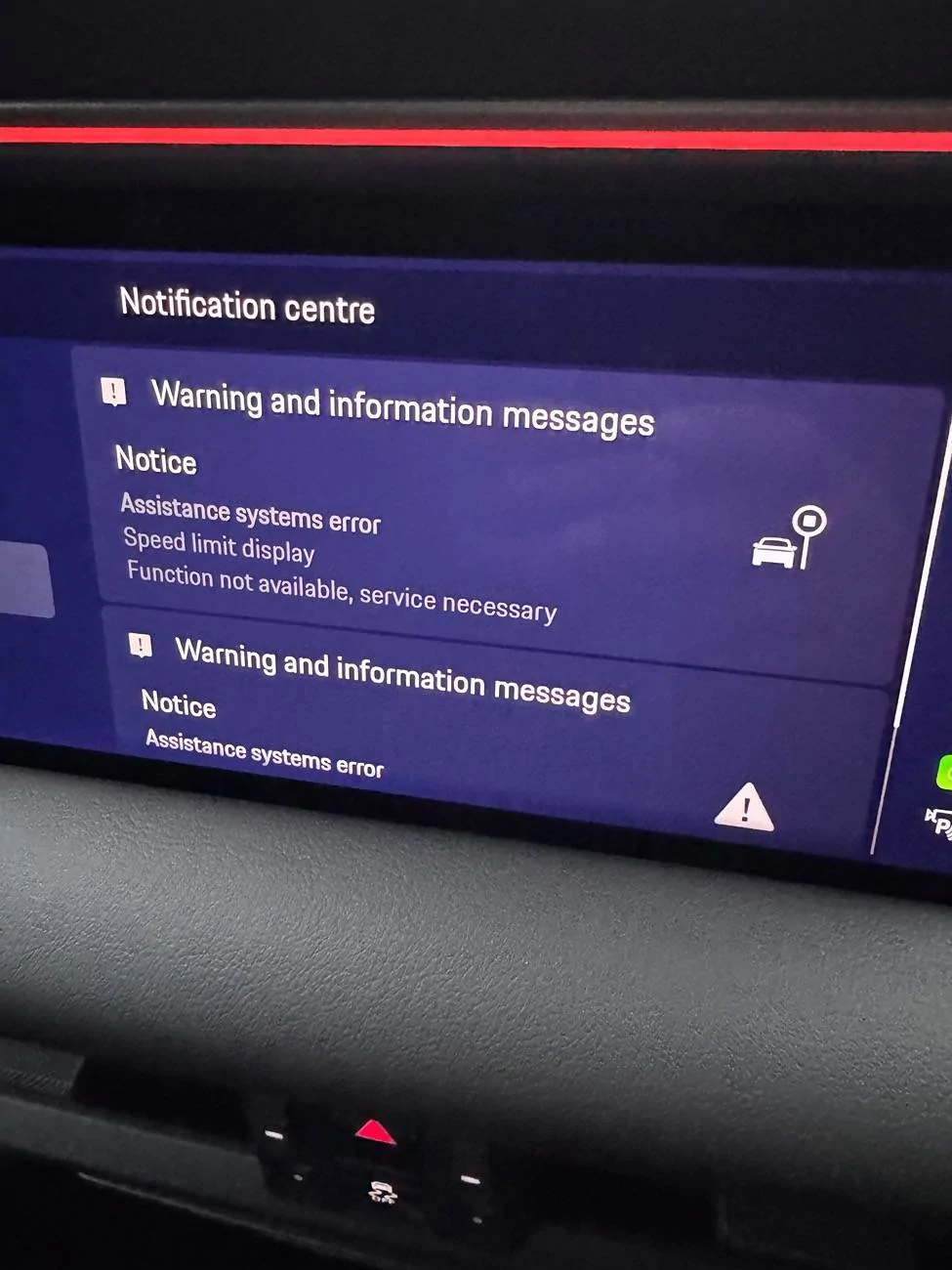

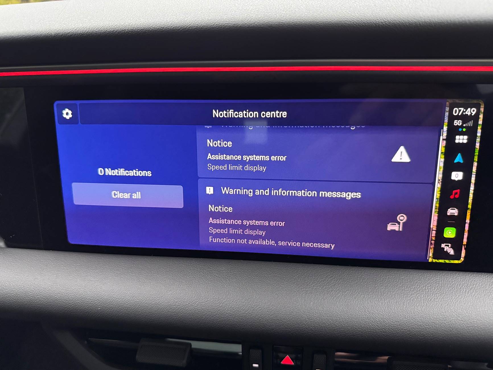

Since day 1, i have regular intermittent fault messages on the instrument cluster
It comes and goes very randomly but unfortunately every day !
-> Assistance systems error / Speed limit display. Function not available, service necessary (See photos attached)
The front camera, windscreen are all cleaned, with no obstruction.
The car is booked in two weeks with Porsche West London….
Watch the space !
Any similar issues ?

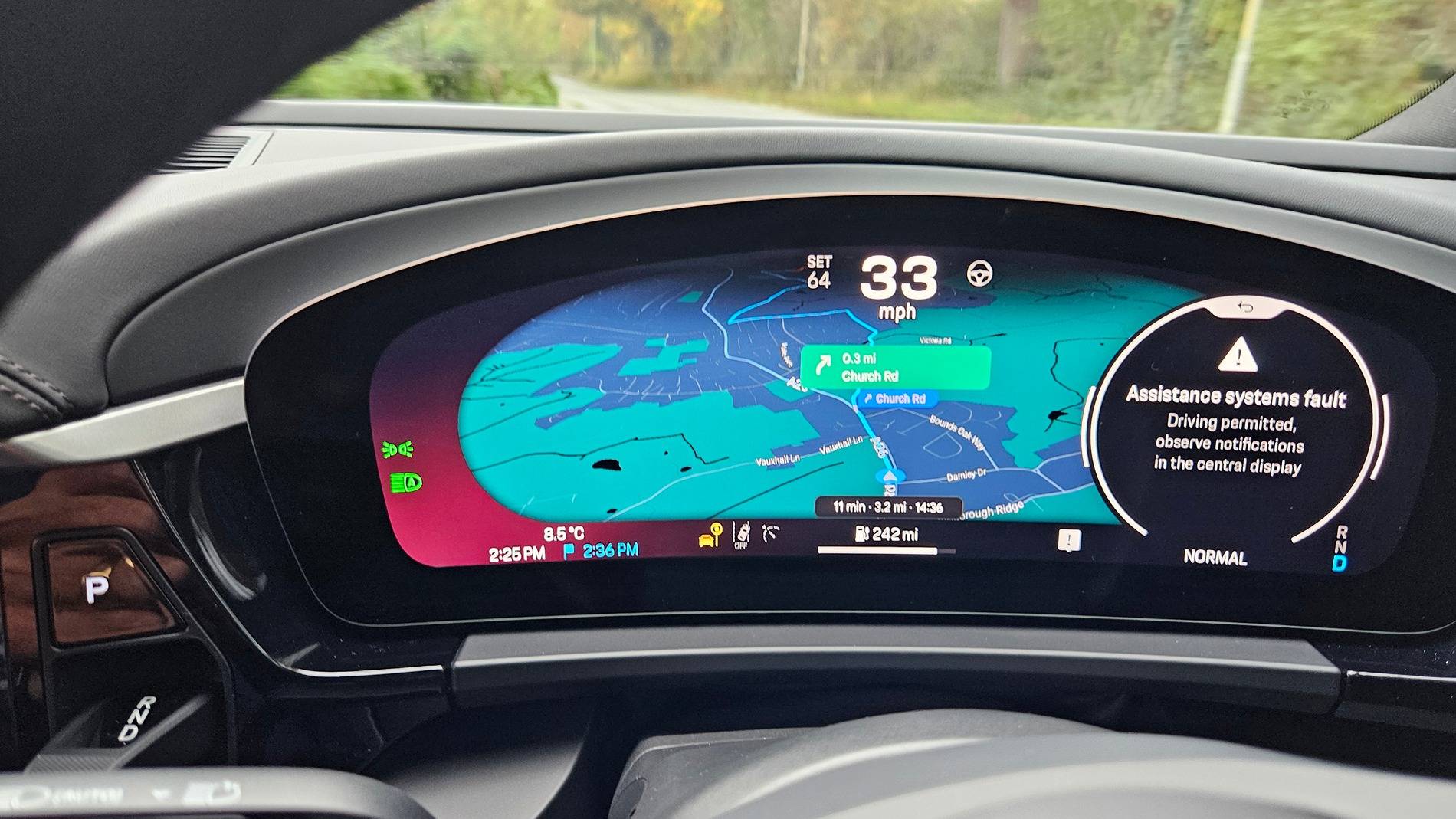

Hi,
I am having the same issue as well from Day1. While the speed limit display fault is no big deal, it disables my cruise control as well. It resets when car is restarted. Sometimes I get lucky, the fault doesn't come on but mostly the fault comes back on. My local Porsche SA says Porsche is aware and they are awaiting a software update. Don't know when that would happen!
Electric Macan EV Assistance Systems Error - Speed Limit Display (warning message) 20241109_142558
