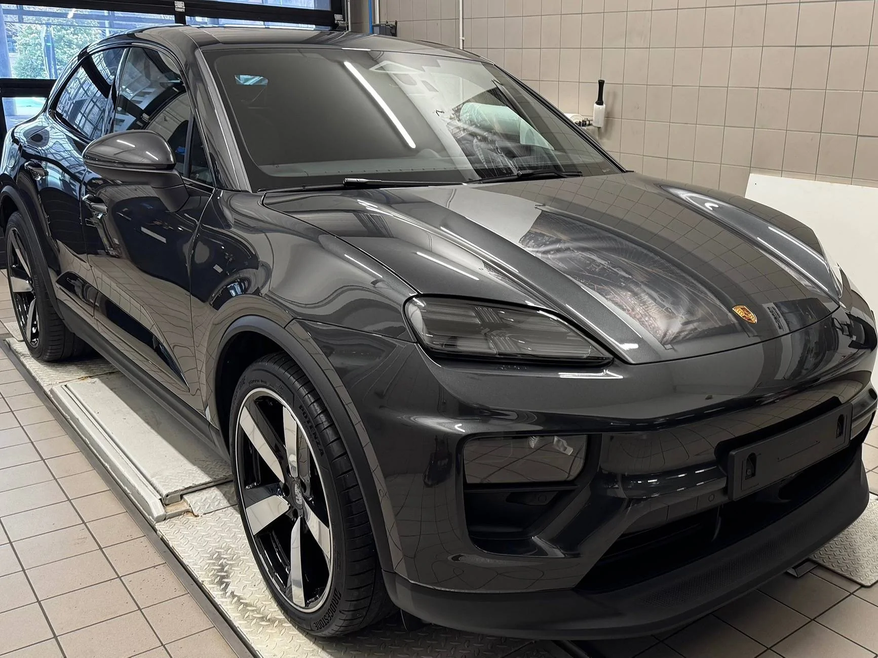

Hello
Mine arrived at the dealership and it's in Bridgestone. Rolling noise does not pass only through the glass.

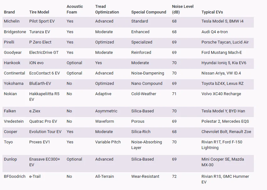

What are people finding to be the best tires (tyres) for comfort and road noise? I understand the tire lottery provides a possible set from Perrelli, Michelin, and Bridgestone... are there any others I missed? For the sake of comparison, specify 20, 21 or 22 as they of course, will impact the choice. Maybe any brand on 20s is the best? Maybe one brand is the best on all rim sizes? I don't know which is why I was wondering. I have Perrellis on 20s and they are very quiet. This is somewhat interesting to the point (although it does not include the Macan) but just wondering what you guys think. The chart below is from How to Choose Tires for Noise Level and Comfort in EVs - Wheel-Size.com

I’ve ordered Pirelli Scorpion MS All Season as they are reported to be quiet and ’comfortable’ - I’m replacing my Bridgestone Potenzaā€˜s (allegedly specifically for Macan’s among other cars). With acoustic glass and air I find them noisy and unduly ā€˜rigid).
