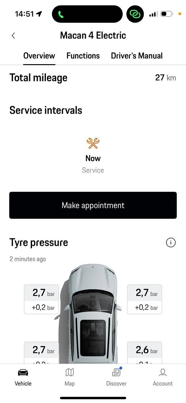

Just curious if your app also shows ‘service now’ 🥶
Yes, it happened to me too. I simply check the car (no warning), close and open again and it return to the correct data.
Check on the PCM that all the info are in the service menù (some of them are linked to the car but other are open (safety pack, tires emergency fluid, and so).

You were right. The mothership had to reset something and now my next service is in 2026. Car ain’t broken 🎉
