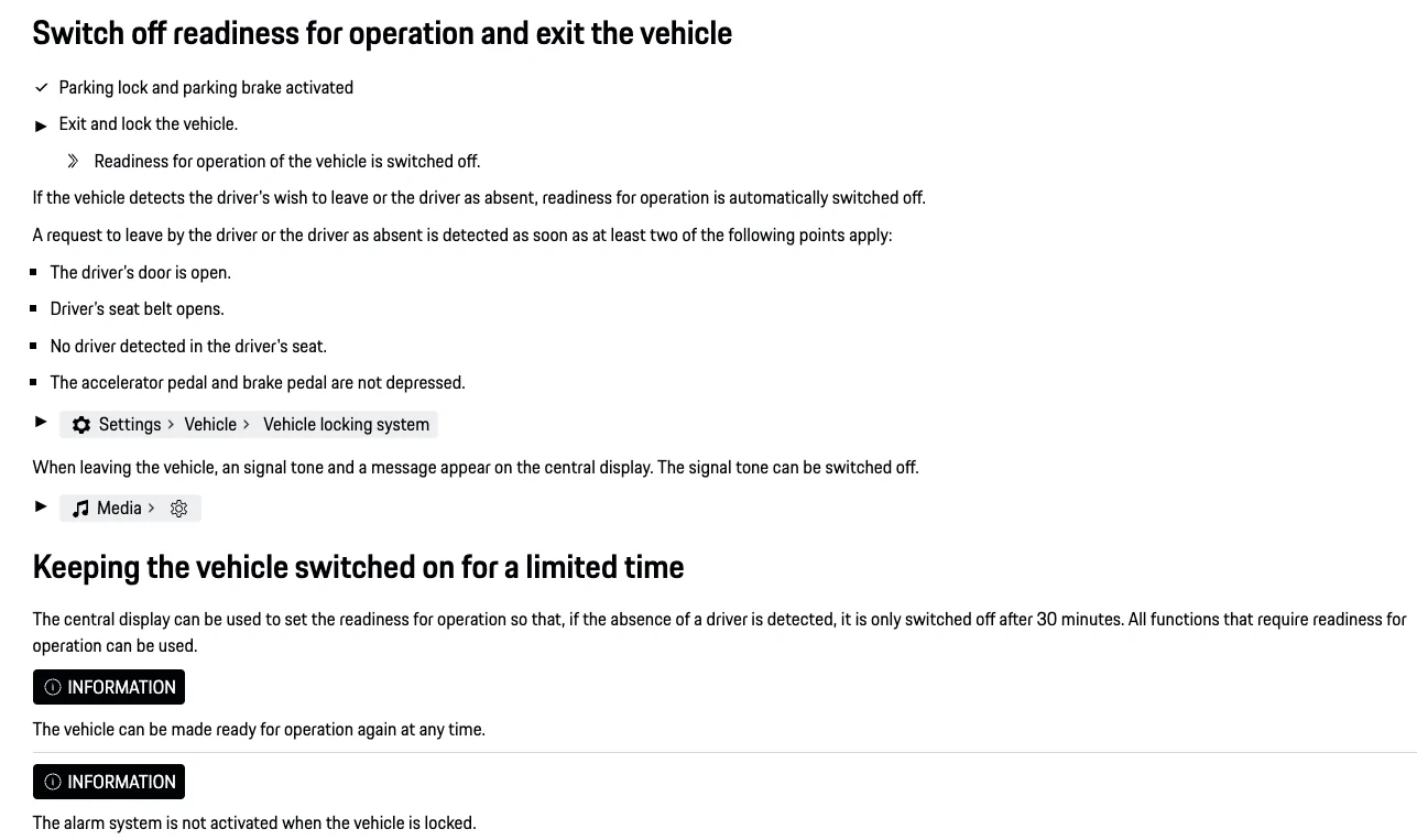

Perhaps this is the explanation & reason:
Electric Macan EV Car turns back on when I get out 1772446851849-tm

There is a setting in the central display which can be enabled (perhaps in error) and will remain on for 30 mins when exiting the car - did you read that at the bottom?
Be sure to hold the power button until the display goes off too if you want to perform the traditional method to turn off a car.
In any event the car is not actually "On" just the displays are lit up - this is "Readiness for Operation" rather than "Ready for Operation" (which requires a foot on the brake pedal and a gear to be selected) - and will ultimately go blank when you lock the car.
The instructions don't even suggest to power off the car when exiting just press P and that is another big clue that it is an unnecessary task but a hard habit to break.
