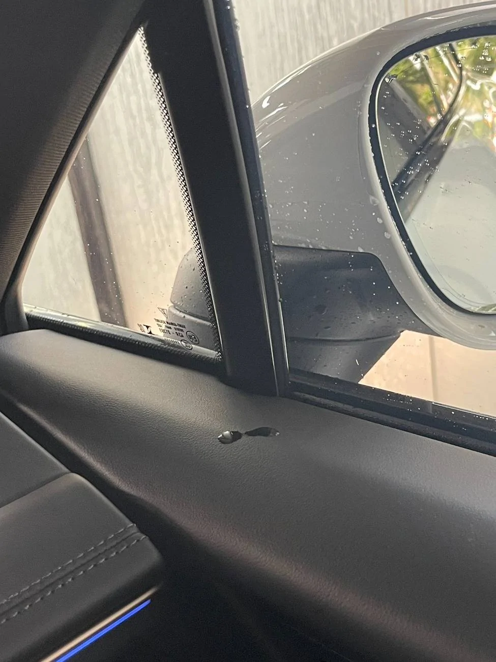

洗車的時候,水會從車窗滲進來。雖然知道是無框玻璃,但這個有點誇張了。

  1. Turn the Car ON. (It is not necessary to start the car.)
  2. Push the Power Window Switch down to lower the Window completely. Then release the Power Window Switch.
  3. Push the Power Window Switch down again. Now this time, hold the Power Window Switch down for 3-5 seconds and then release the Power Window Switch.
  4. Pull the Power Window Switch up to raise Window completely. Then release the Power Window Switch.
  5. Pull the Power Window Switch up, again. Now this time, pull the Power Window Switch up for 3-5 seconds and then release the Power Window Switch.
  6. Turn the car OFF
  7. Turn the car ON
from rennlist: https://rennlist.com/forums/992/1362103-window-automatic-up-down-reset-procedure.html

Yes, this solution has worked for many, as it was posted before. Good to mention this solution again 👍

我的意思是,如果你在關上車窗的情況下洗車,水就會從車窗滲透進來。

I have had it handwashed with jet spray quite a few times, no water seeped in through windows.

I have washed my Macan 4 EV with a pressure washer more than 10 times and never had a leak problem.
Remember: do not have the comfort access systems enabled with the key near the car when washing it.
Also, "resetting" the window heights (as previously stated in this thread) is usually a solution.

感謝您的回复,我會再試一次
