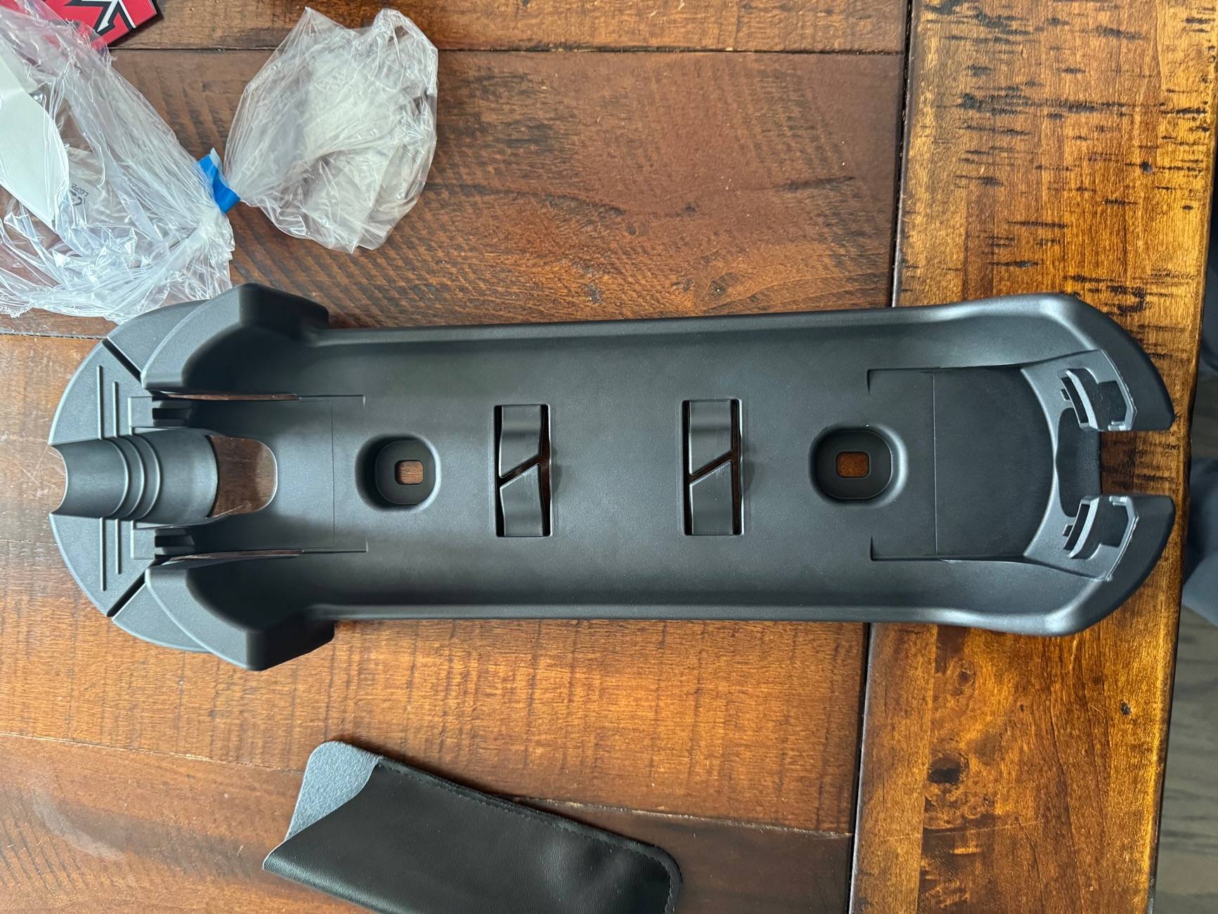

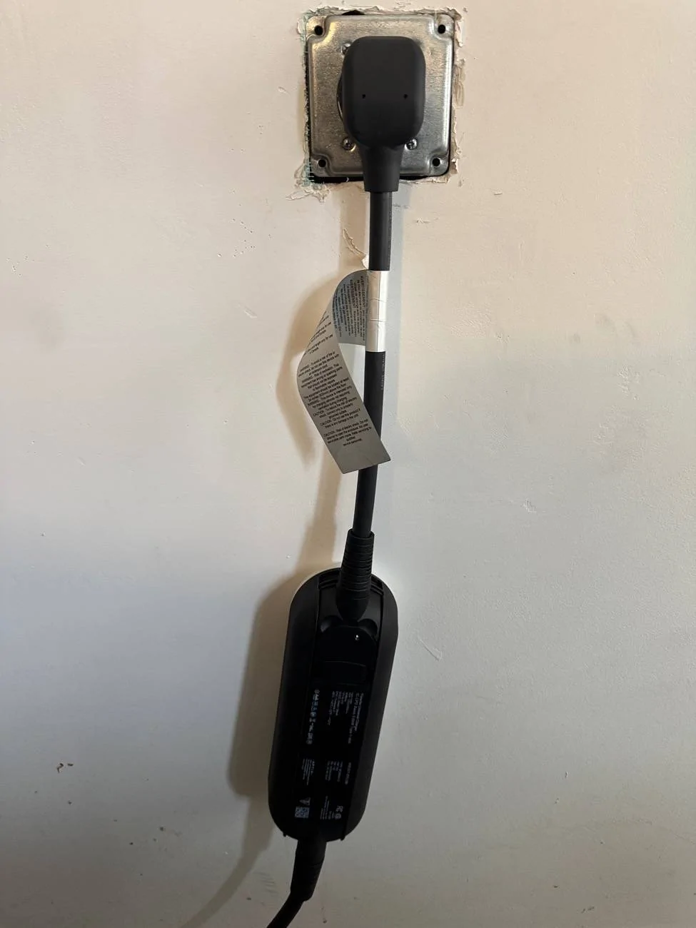

Has anyone had any resolution from Porsche for the fact that the plug faces a direction that makes using the mounting bracket virtually impossible without significant torsion on the cable?

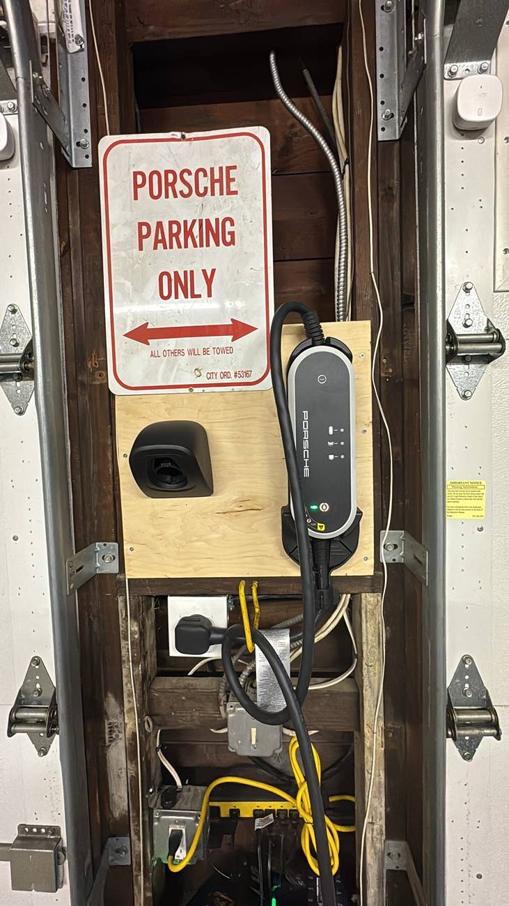

That’s odd, mine points the correct direction. Lights and controls facing out when plugged in…

My quick solution was to open up the electrical box inside the wall and turn the plug 180 degrees. Now the plug chord goes towards ceiling vs floor. Make sure to disconnect the power to outlet before doing.
439
450
Not sure it fives the problem, the front of the charger will still face the wall. Maybe twist the cord and secure the charger. Hopefully with time the cord will adopt this position without having to force it into it. I checked my Porsche's mobile charger and the cord fits in the right position.
