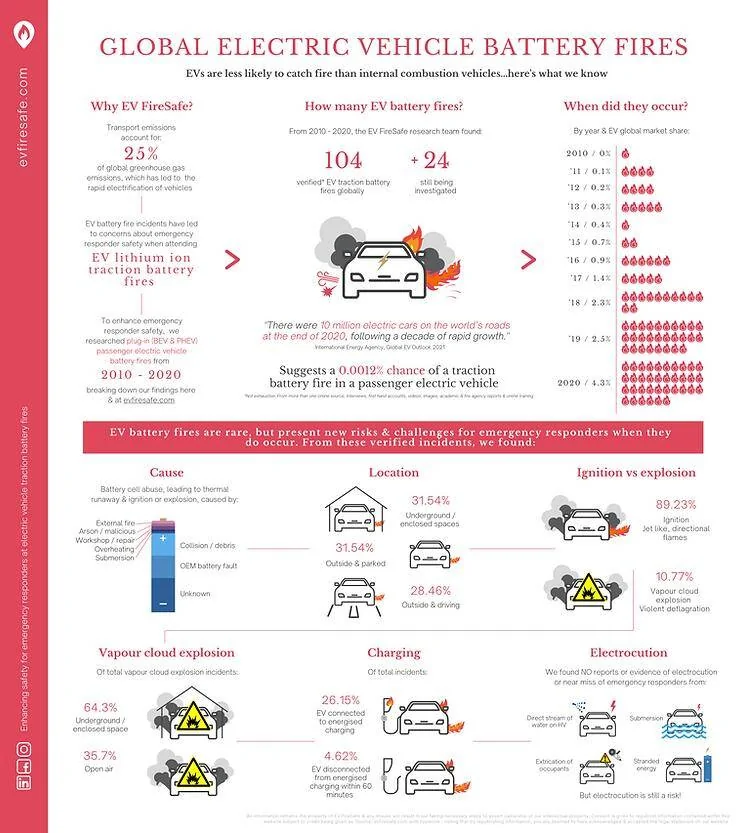

How do you all feel about battery safety...(might be a different thread but....)?
I'm keeping mine outside all of the time, not just when charging. The chance of the battery melting down is pretty low, but not zero and if it does, I don't want to lose my house. I'm keeping my 3 other cars inside...my mini-collection ('07 997S manual, '06 Cayenne manual and my 1990 VW Vanagon:). The Macan is my entry into modern times:). Love it so far!
yeah battery worry is overdone…
your gas cars are far more likely to go up in flames
