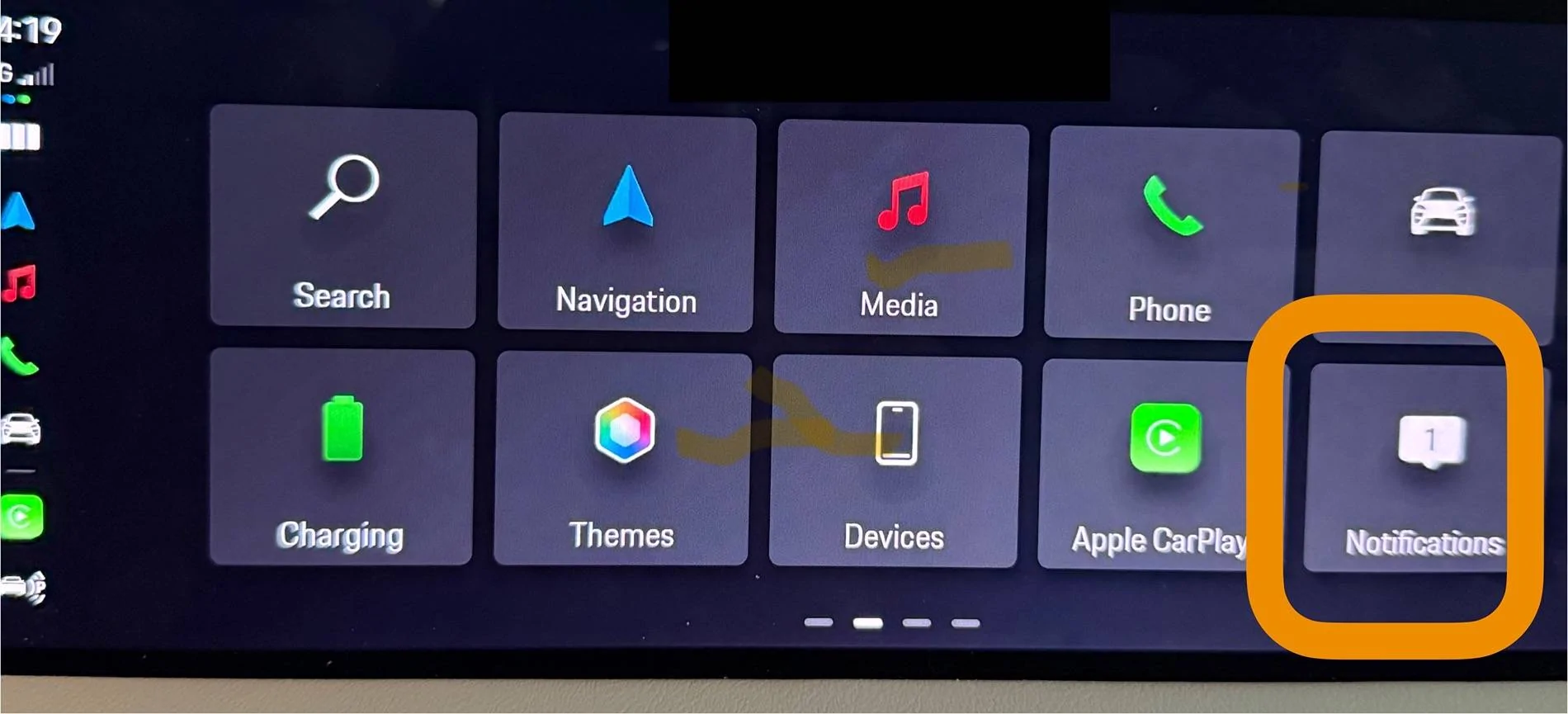

I have seen this error only once. The message center gave additional information regarding pre-climate. I use that feature rarely now because I’ve seen other errors when trying to use it as well.
At the risk of telling you something you already know, look for the comment bubble icon in the PCM. Hopefully the message will prove helpful

I checked the notifications, but did not seem helpful. I did try two different stations. the first, an Electrify America had others successfully charging. I did try to connect a couple of times to no avail. At the second station, a ChargePoint, I got the same error. While waiting for the tow vehicle after about an hour, the Macan did charge.
