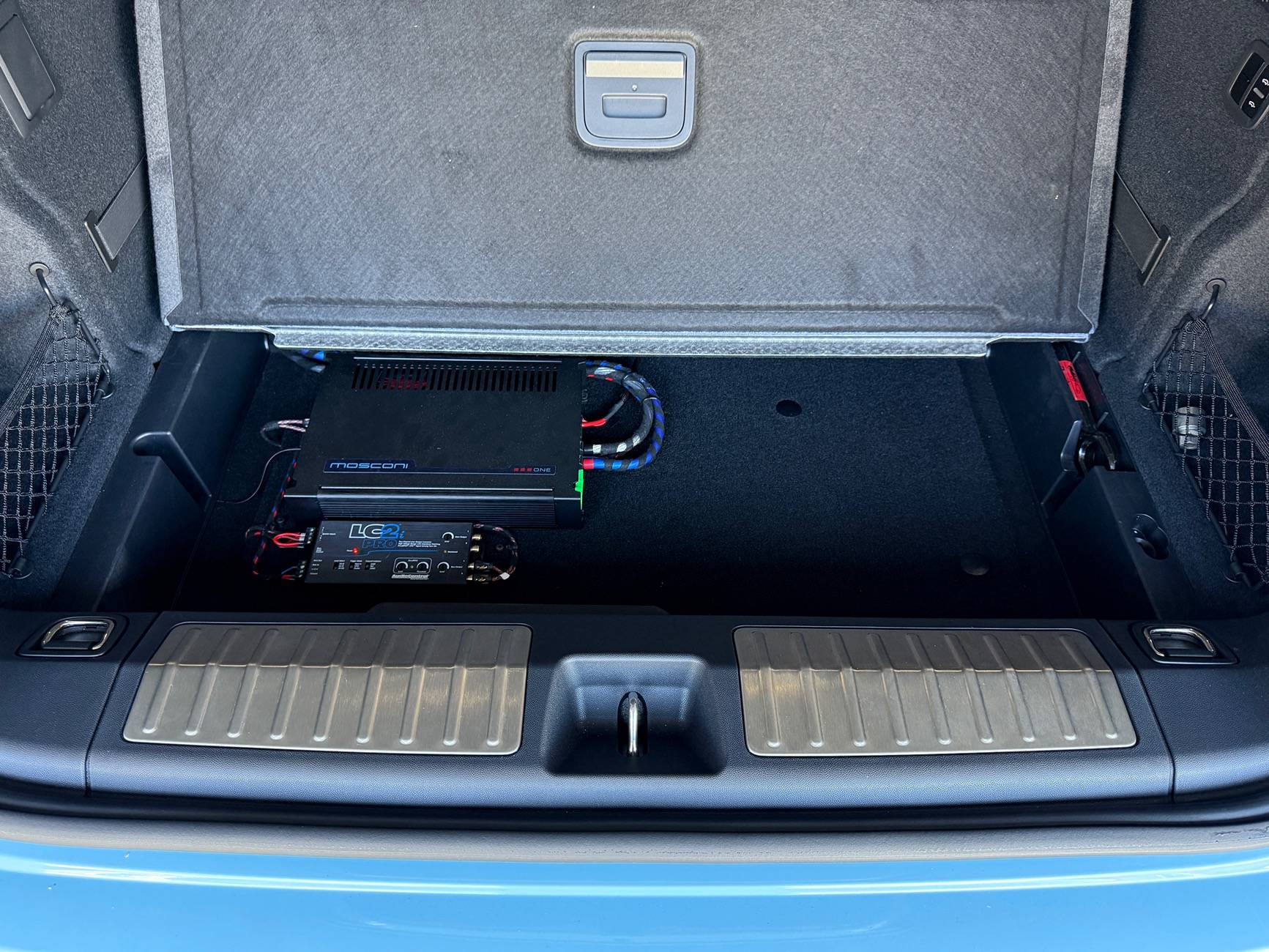

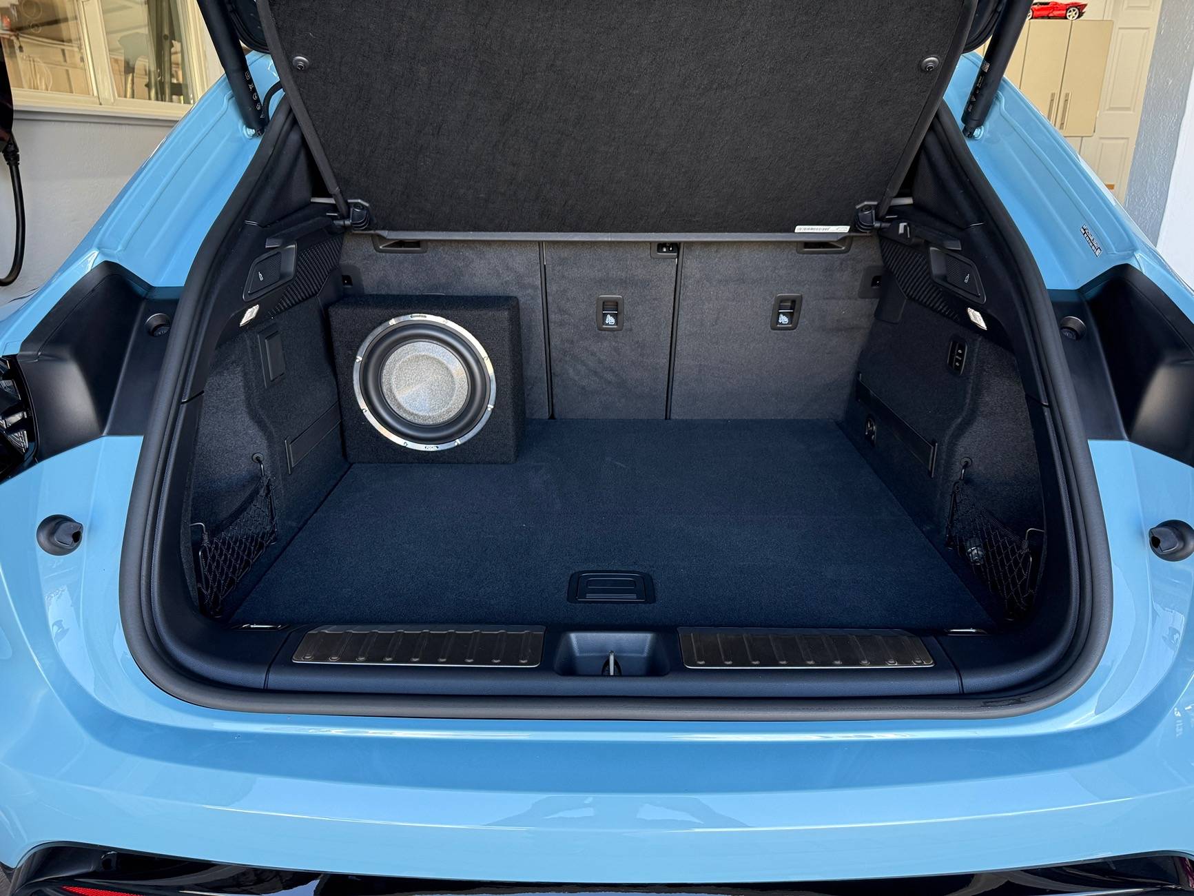

Update on my install, phase 1 complete. Bose sub out. Factory speakers out. Focal speakers, including 10” Utopia sub Installed.
Still have the Bose amp powering interior multi channel. MoBridge guys working on a solution for this new amp, so we can replace with Mosconi multichannel with DSP for better power and tuning.
Sound with stock Bose amp and improved speakers is significantly better. Sub with sub control knob under the climate control panel for easy adjustment when needed.
Sub is held in place with Velcro and quick release connectors. If I need more truck space for larger item haul, it comes out in 1 min.
Very happy with the result, but looking forward to phase 2, to complete the install.
Big thanks to Raymond and team at California Car Sounds in Campbell for the great work on all my previous stereo upgrades, and executed this one beautifully.

Focal P60 for fronts
Focal Kevlar series for rear
Focal Utopia M 10” Sub in custom enclosure
There are some good guides and product for self install. Crutchfield.com might have more info for the self install details. My stereo shop handled it.

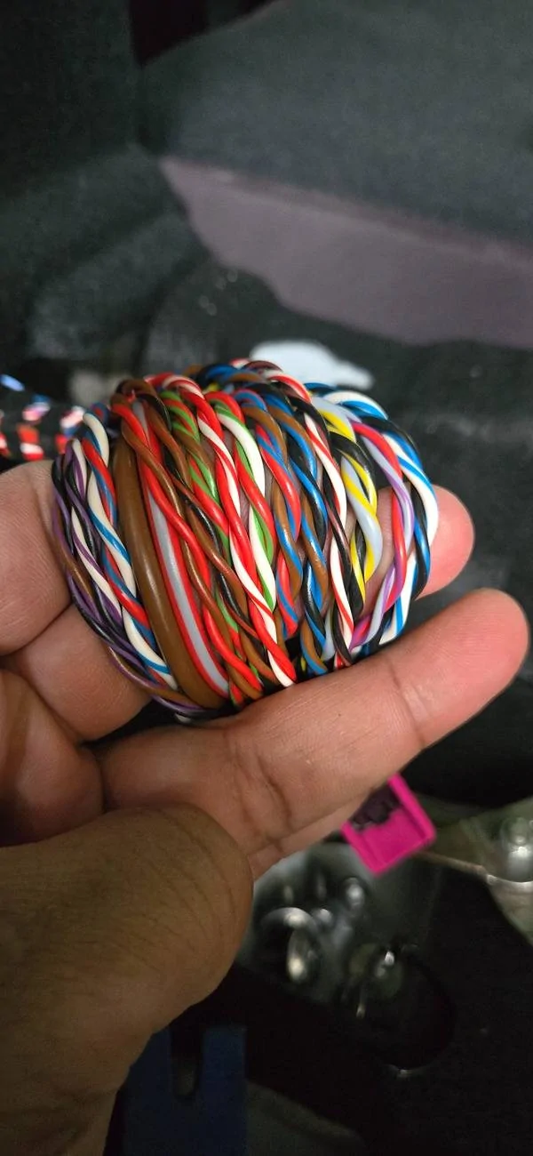

ok. i'm diving into this.
but lookin at all the wiring diagrams, nothing i'm finding out on the web is matching up. @themacnut you wouldn't be able to see what colors your installers tapped would you?
I was originally looking that Violet/VBlck and Green/GrnBlk wires which in diamgras i find (for tother porsches) coordinate with rear speakers
but on our car, there's no solid violet.
there's Wht/Vio and Blck/Vio, Wht/Grn and Grn/red...
what's making me cautious, is the green wires are a different gauge than the Violet wires....So i don't think these actually match both rear speakers
