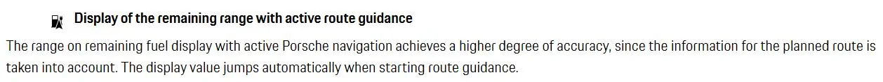

1)
Electric Macan EV Charging planner experiences Screenshot 2024-10-15 154210
