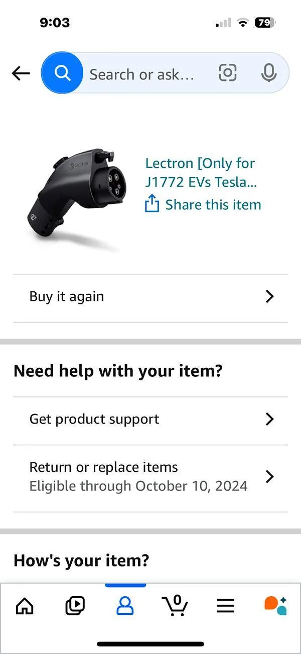

That’s the one the dealer recommended
Electric Macan EV Charging using Tesla home charger with an adapter IMG_1753
