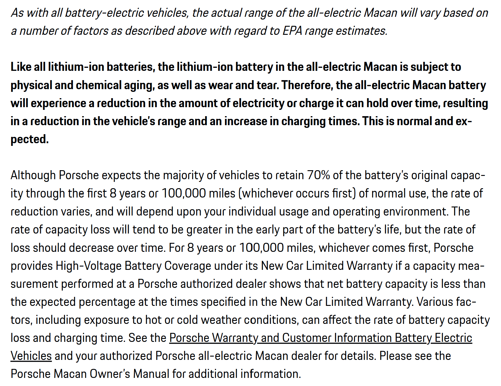

Valid concern. Degradation is normal. This is directly from Porsche.
Electric Macan EV Degradation of the battery 1766028178529-11
Thanks . Yes I Had already read it . My questions was based on the real degradation of your battery’s as current drivers .
