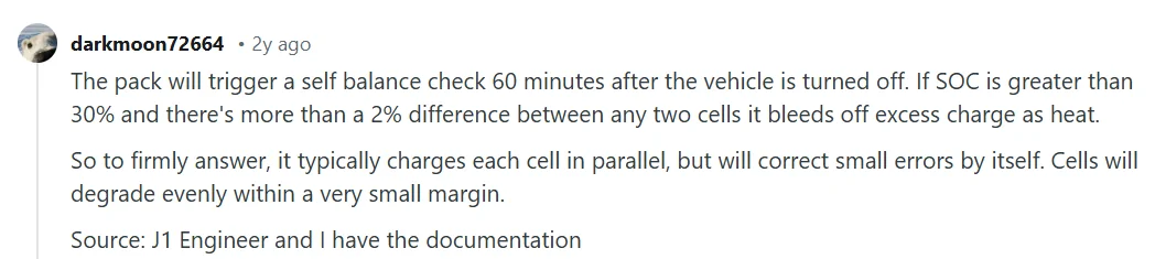

Looking around this thread I stumbled upon link to another where I found somebody claiming that Taycans will trigger their own battery rebalance if BMS detects imbalance. A little bit more googling and I found this post on Reddit about Taycans which seems to fit the bill perfectly:
Electric Macan EV Does your Macan EV keep SoC stable when left idle for a week or longer? 1775258024098-8
So I guess there is something wrong with our batteries and their cells gets out of balance way too often or BMS has some sort of problem and it is triggering this rebalancing even when not needed. If this is really the case even for Macans I will be really pissed off, because there is no way that Porsche is not aware of this since it seems to be a feature of their BMS.

I do think this is a BMS self-balancing problem - either a software bug where it's confused, or a real problem with a cell triggering the process.
