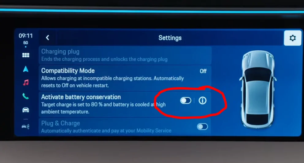

I think I have good news, although it needs confirmation.
My Macan belongs to the club that loses 1% of its charge daily. Or maybe not anymore.
In the past, I tried a bunch of things to figure out the cause: I disconnected the dashcam, I didn't connect to the app to check the status, etc. Same result, it kept losing 1%.
One thing always caught my attention: the battery temperature was always about 4 degrees higher than the garage temperature.
I tried something new. I left the car with 43% and 206 km of range. I waited 4 days. Finally, I opened the car and saw this: 43% and 217 km of range.
I thought, now I'll drive a kilometer and it'll drop 4%... It didn't.
I drove 3 km and it showed 43% and 212 km of range.
Another detail: the garage was at 15 degrees Celsius and the battery was at 15 degrees Celsius.
What had changed?
The user manual and this video explain that the battery care function CONSUMES ENERGY to maintain the optimal battery temperature.
And this is what I did:
Electric Macan EV Does your Macan EV keep SoC stable when left idle for a week or longer? 1773473453624-0k
And it worked, 0% loss.
I only tested it once, so it should be repeated, preferably by more users.
If this is confirmed, the question remains: is it worth keeping the battery care function active when we're talking about moderate temperatures (10-30 degrees Celsius) without direct sunlight?
Obviously, the charging limit of 80% can be maintained even with the function deactivated.
Are you willing to try the experiment and share your results?

Not sure if this is the solution as mine and other cars are losing charge even if it's cold outside and around 6-10 degrees in the garage. This function is saying that it will cool down the battery when it's too hot outside. I would definitely not consider 6-10 degrees (Celsius) as too hot.

My guess is that the activated battery conservation function forces the car to "wake up" the BMS more frequently to check the battery status. This will result in energy consumption.
It's well known that low temperatures are also detrimental to long-term battery health. The owner's manual only mentions cooling the battery, I know, but it seems unlikely that the BMS wouldn't try to warm the battery if it's excessively cold.
In any case, we can only make assumptions and try different approaches, since Porsche (and all the others) doesn't provide much information about how their vehicles work.
One question. When your car has been parked for a few hours, does the outside temperature match the battery temperature?
What had changed?
I'll certainly give it a try!I'm experiencing exactly the same,my battery is always 4-5 C above ambient temperature inside my (or any) garage.I even remember one time I left the car with 37% SoC for almost 2 weeks and there wasn't the slightest % loss and also the battery temp was the same with the ambient temp.Maybe below a certain % SoC the BMS stops keeping the battery at a certain temp range,as a safety feature to prevent complete battery depletion.
Yes, I'd say it matches the outside temperature more or less. At least it's not recognizable that it's way warmer or colder.
