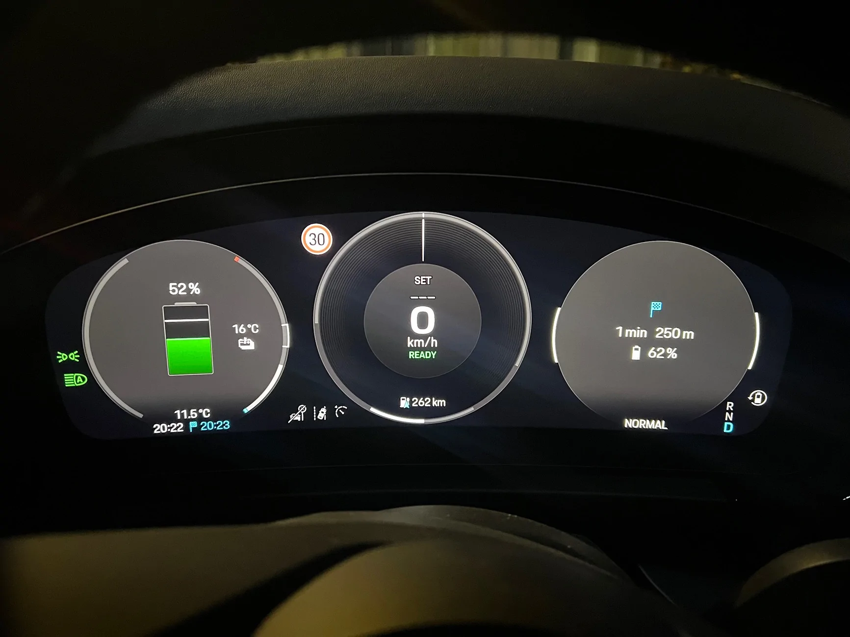

Since the latest update and after 3 months at the dealership, my car has gone crazy with the SoC...
in less than 3 days, when idling in underground parking at 14C, 9% has disappeared! I regret my 1% loss per day...
Another thing very strange: 250m to reach the end of my trip, SoC at 52%, but the nav said that the SoC will be a solid 62%.
The remaining SoC became totally non reliable since the update, and shows a SoC at destination that is superior than the current SoC... last time it was 67% for the current SoC and 85% for the estimated SoC at destination.
WTF Porsche , a reliable SoC is one of the root feature in an EV, and you can't deliver that.

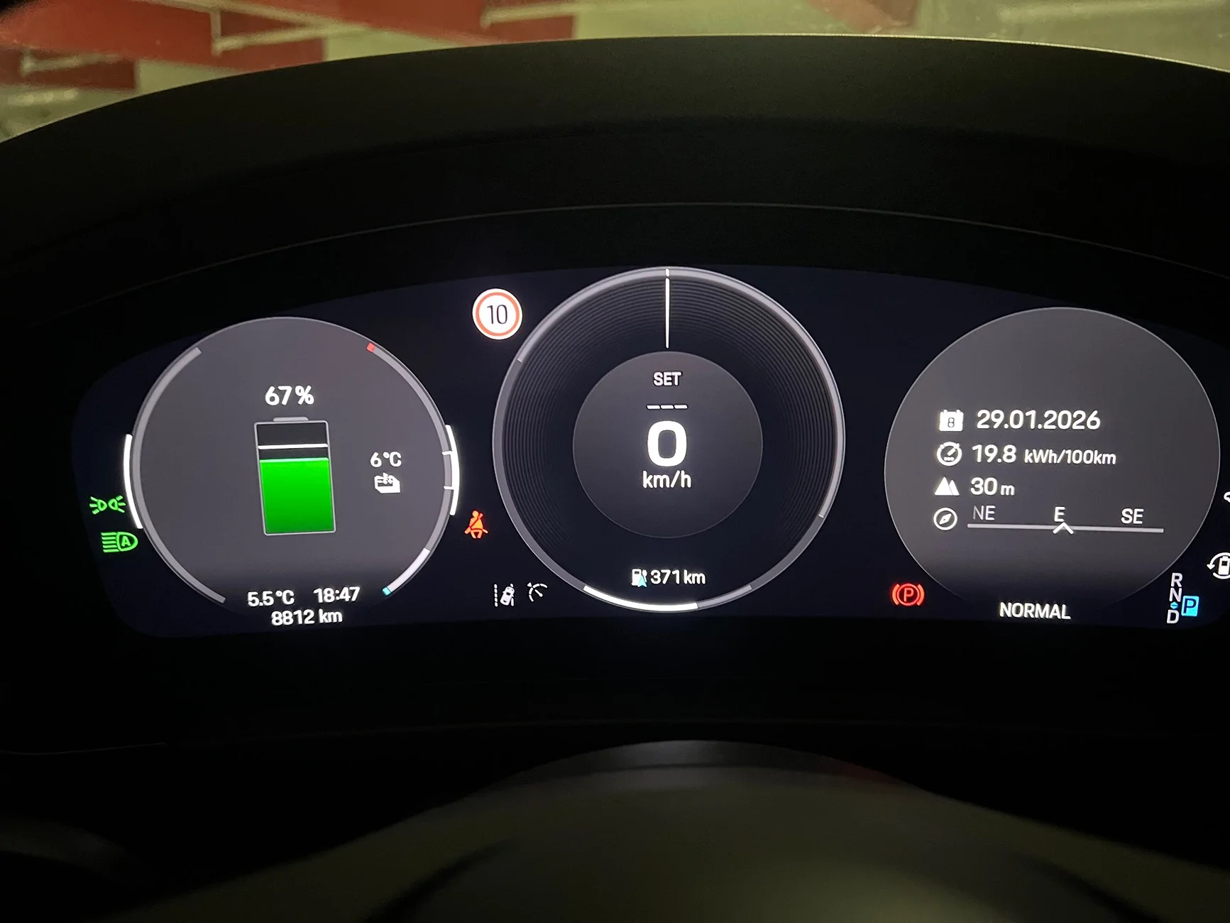

For the record:
29/1: 67%

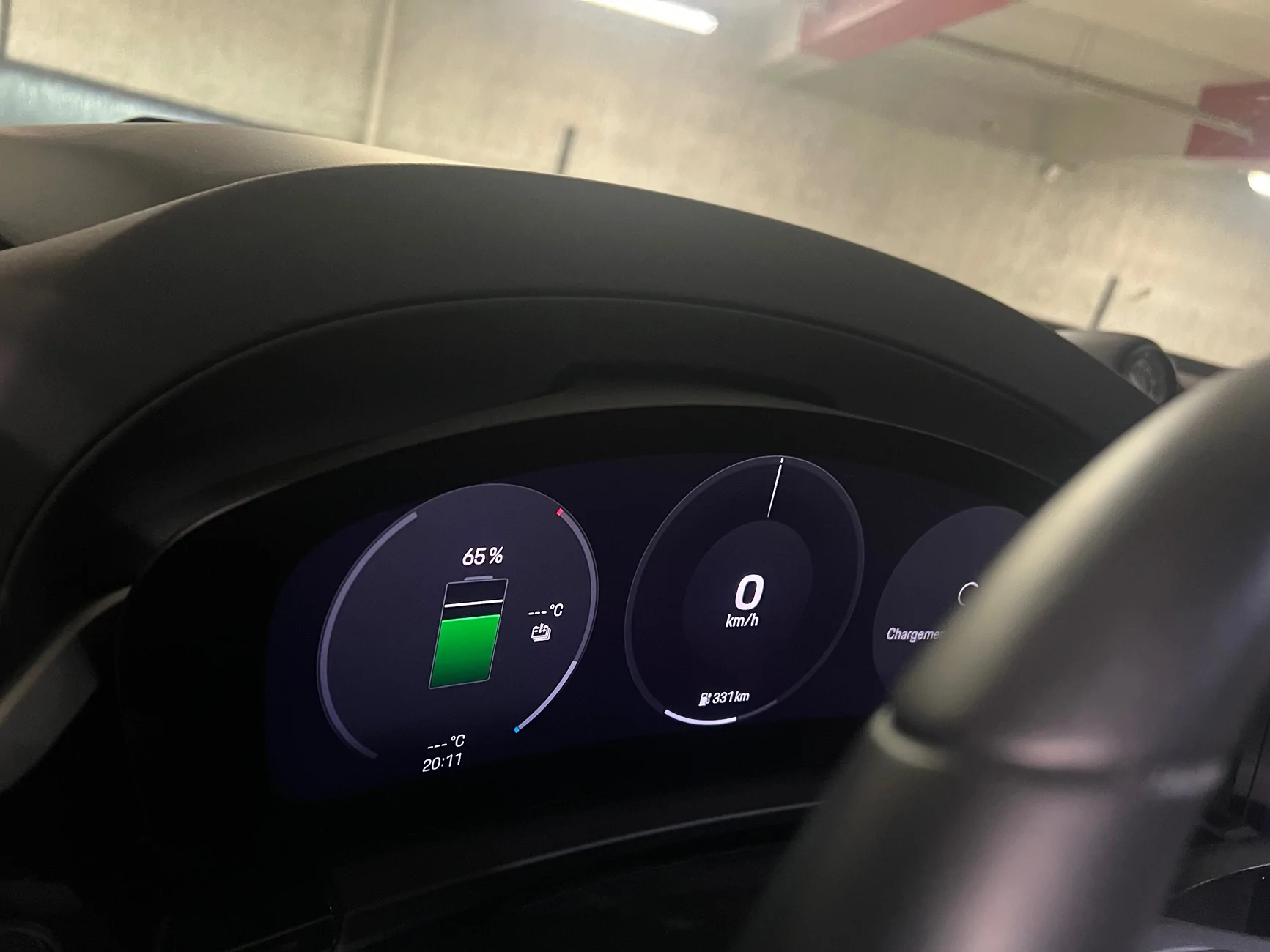

Electric Macan EV Does your Macan EV keep SoC stable when left idle for a week or longer? IMG_0152
3/2: 65%

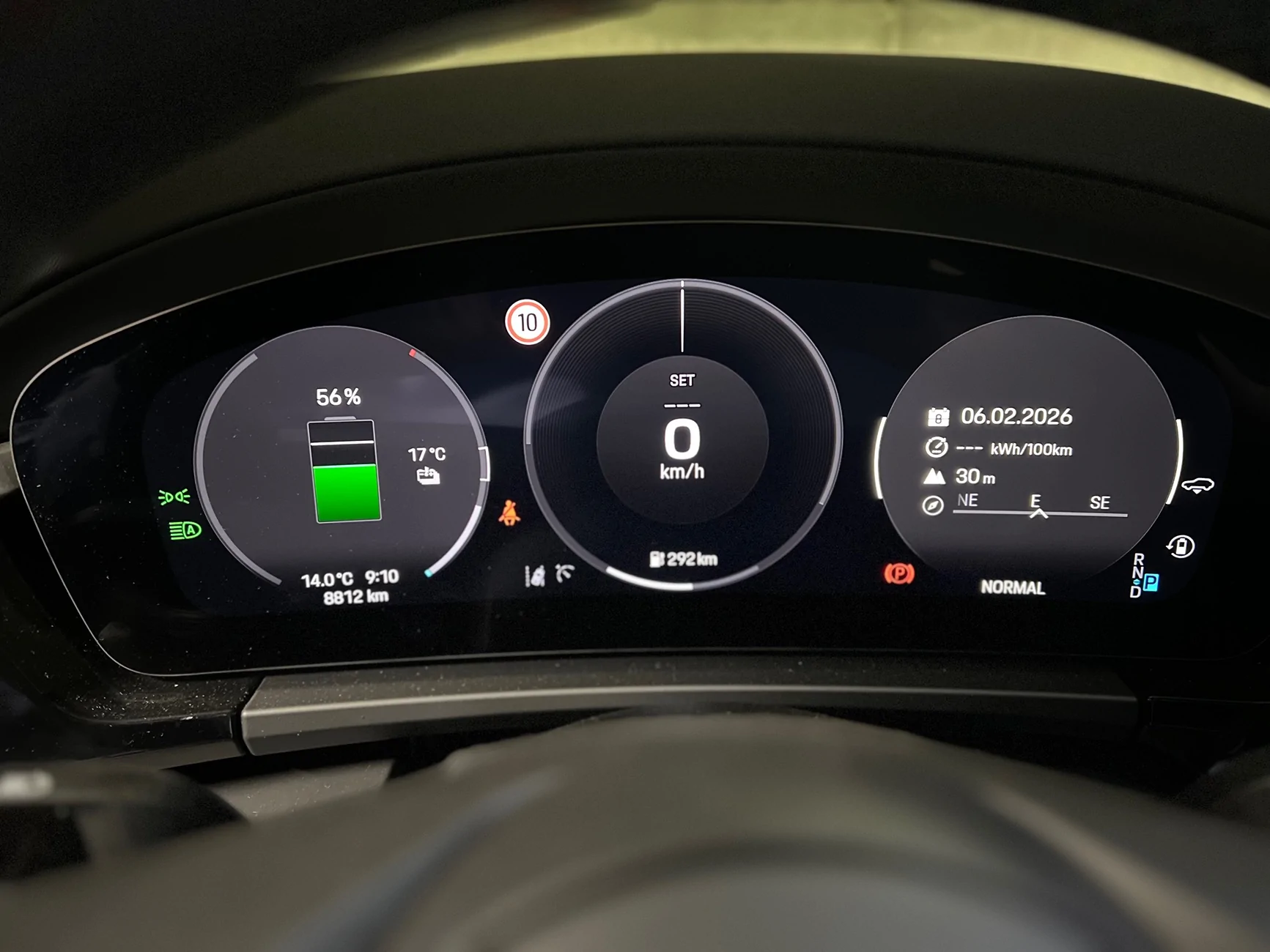

Electric Macan EV Does your Macan EV keep SoC stable when left idle for a week or longer? IMG_0247
6/2: 56%
Also had that one way before first SW SW update done. I had to live with it for 4 months. Dealer did 2 SW updates promising that they will fix it. They did not and eventually I had to figure out solution on my own. Try switching to Guest account and it will show correct estimated SoC. Keep it under Guest and do some longer drives and it will eventually also fix your account.
