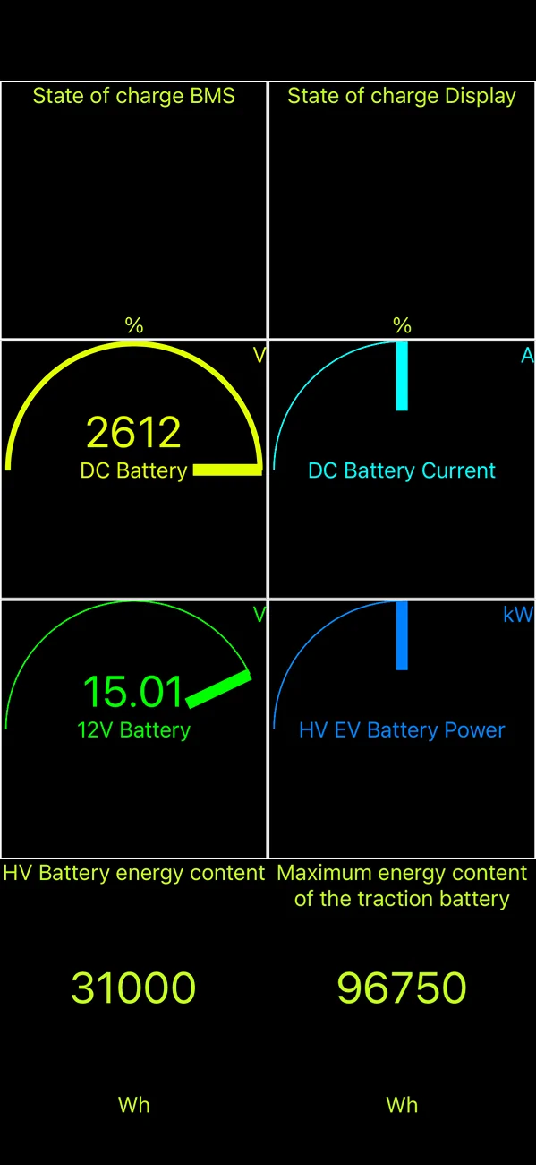

The BMS reset was performed by my dealership on the same day as the "big update." I don't have any further details, except that I fully charged the battery before leaving the dealership.
This is my dongle, bought for my Taycan :https://www.amazon.fr/dp/B08NFLL3NT?ref_=ppx_hzod_title_dt_b_fed_asin_title_0_0
The Carscanner and Eflow app haven't been updated for the Macan, most likely due to Porsche's refusal. The Macan manual warns users about these on-board diagnostics.

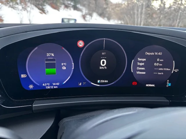

The only potentially useful information is on the lower of this this screen , with a SCO of 37% :

For the record:
29/1: 67%
3/2: 65%
6/2: 56%
One thing that I noticed recently when mine SoC drops while stationary started being bigger (although still not so drastic as yours) and it seems to be shown also on your photos is fact that during these bigger drops battery temperature is raising. Mine went from 11C to 15C while outside temp in garage barely changed.
