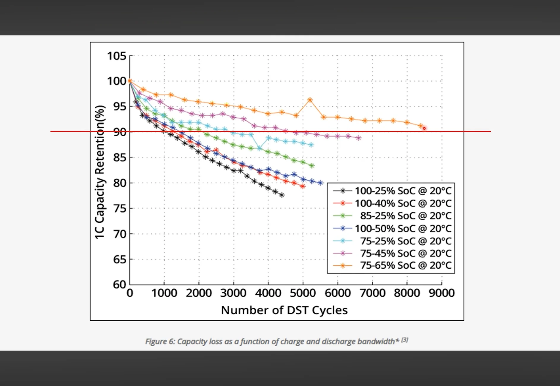

interesting research
Electric Macan EV Does your Macan EV keep SoC stable when left idle for a week or longer? IMG_0198
see:
