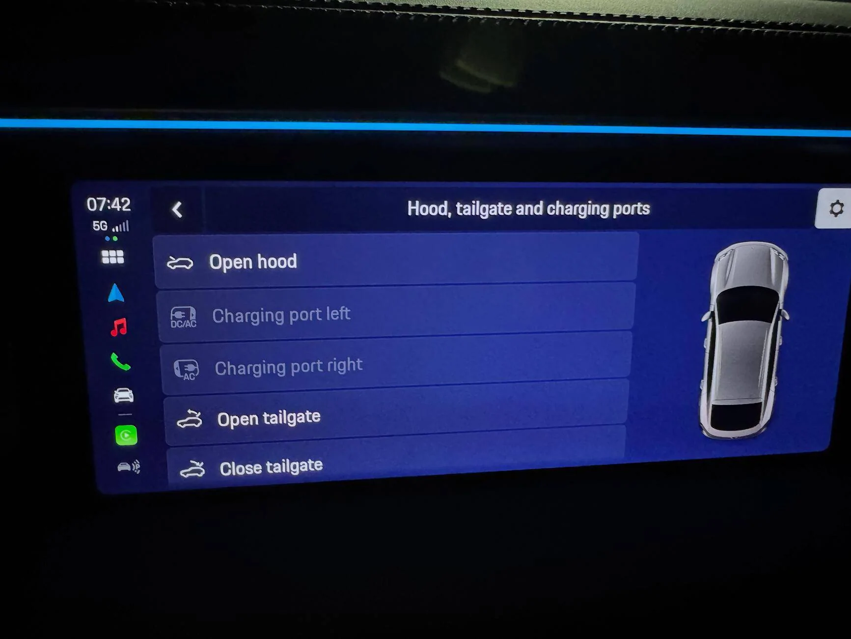

I’ve had my Macan 4s EV for a few weeks and have charged it a couple of times without issue. The car is fitted with electric charging ports. Today I attempted to open the charge ports and neither would open either physically or via the PCM Menu which says. ‘Function not available’ when selecting either the AC or DC port. I left the car for about 6 hours and returned with the same outcome. Has anyone encountered a similar issue?

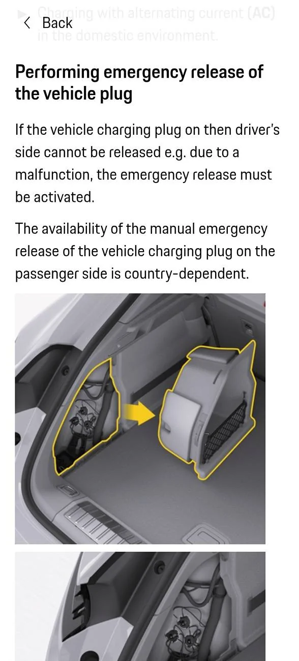

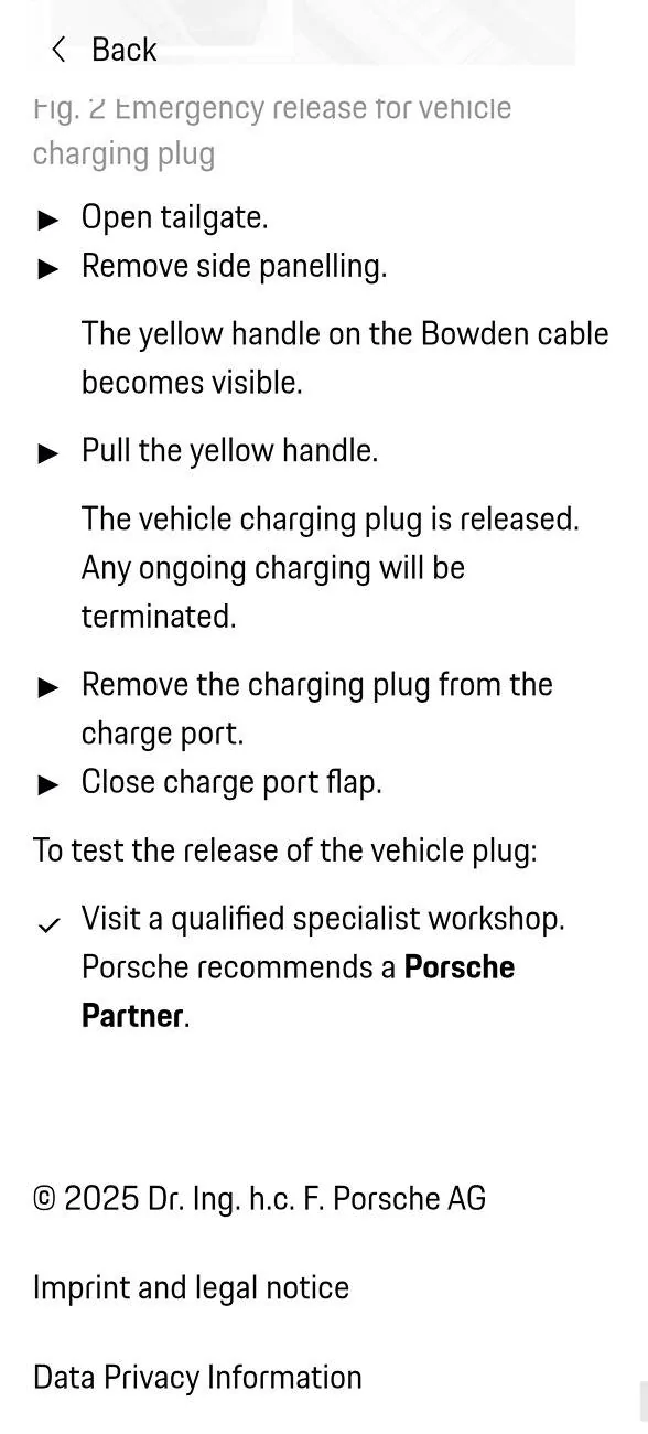

There have been several reports that the electric charge ports are unreliable. You can’t manually open them? You should be able to do that (as long as the car is unlocked)
