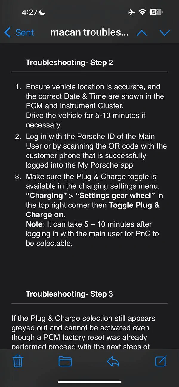

Attached below are screenshots of the P&C troubleshooting steps I received from a PCNA tech support phone rep.
Electric Macan EV Plug & Charge Issues IMG_5856
Electric Macan EV Plug & Charge Issues IMG_5857
Electric Macan EV Plug & Charge Issues IMG_5858
Electric Macan EV Plug & Charge Issues IMG_5859

"Factory reset" is not referring to restarting the PCM (long press and hold for 30 seconds on the volume dial).
"Factory reset" is performed as follows:
I also had to do it on my Macan Turbo earlier this week, and it then solved my P&C issue.
I was unable to get plug and charge working since I took delivery a month ago.
I made sure I was in an area with good cellular coverage, logged out of the My Porsche app on my phone and followed these steps exactly… plug and charge is now enabled on my 4S.
