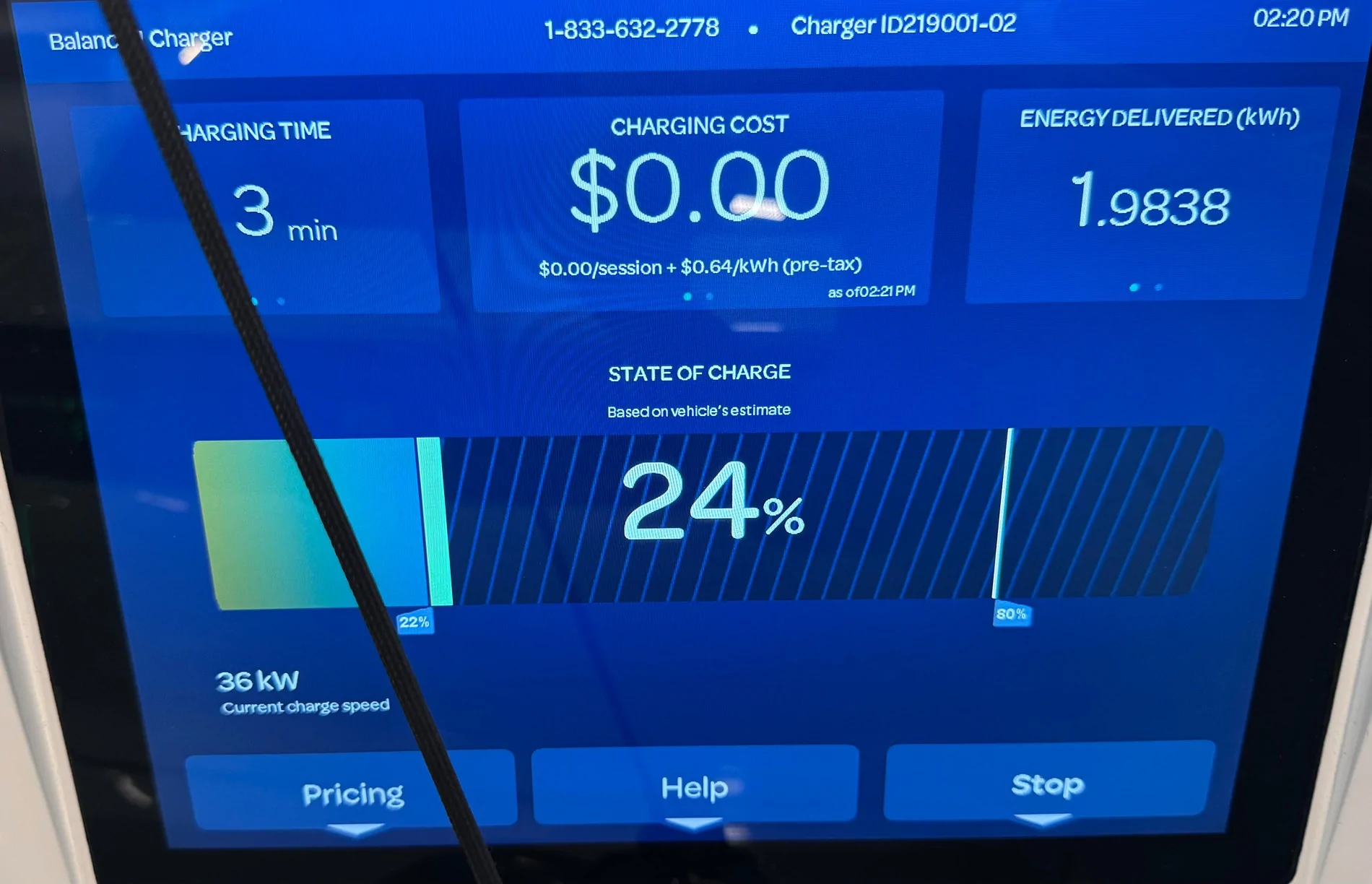

Todays update.

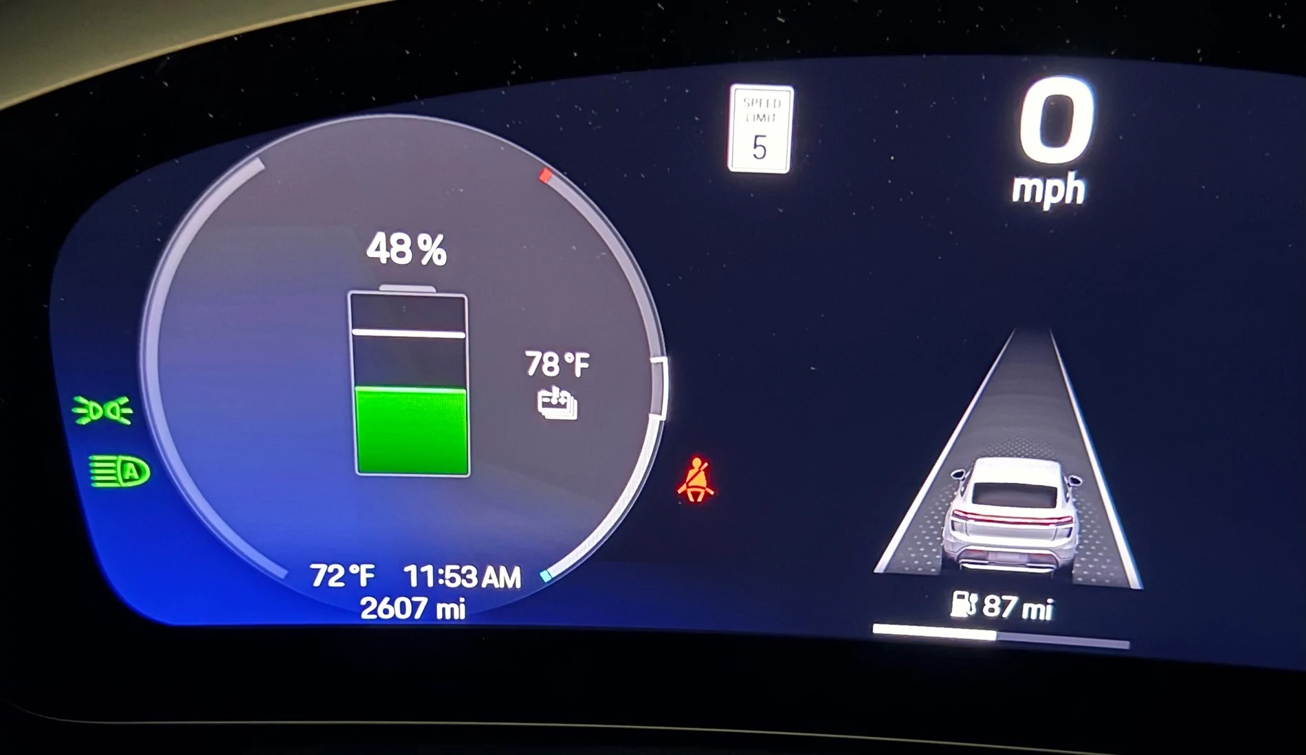

Decided to put some miles on the car to drain the battery. Lunchtime trip from San Francsico to Cupertino for lunch with a friend, then back.
Arrival in Cupertino:

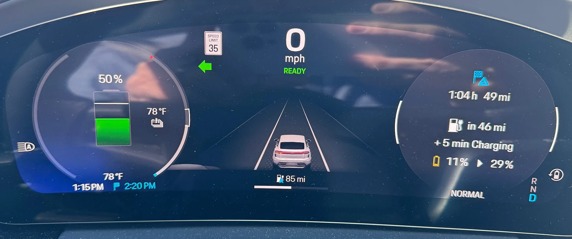

After lunch I set the Porsche Trip Planner to head to the EA Flagship in SF as a first stop, then home:
(note also "only" 86-mile range at 50% charge on a bright sunny mid-70-degree day)

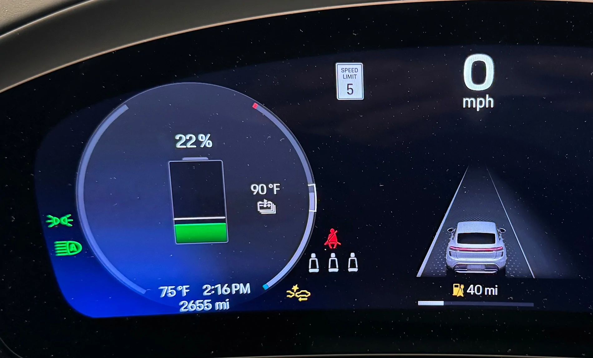

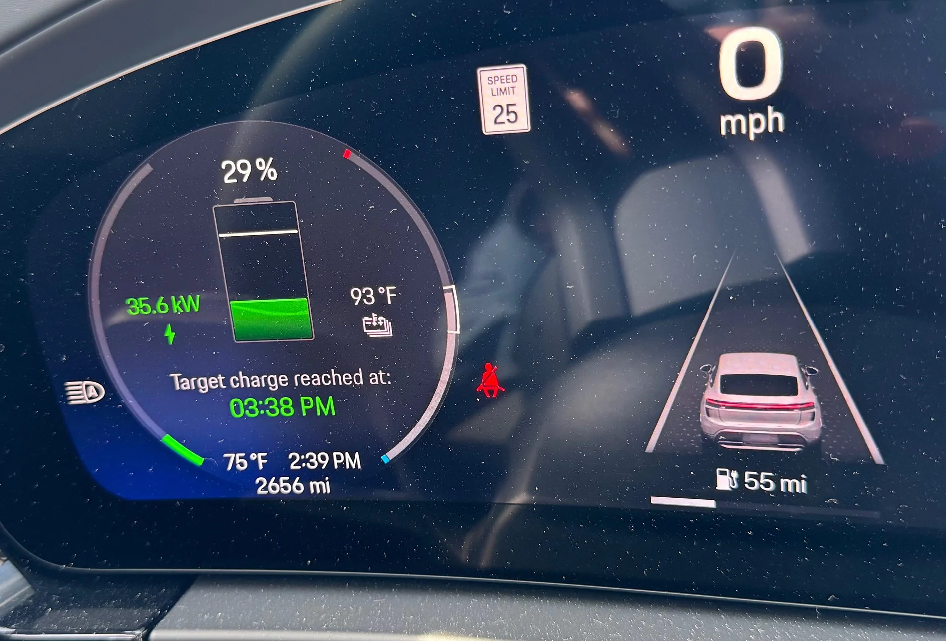

Arrival at EA SF: Battery at 90-degrees. Battery SOC at 22%. Ideal for fast charging, or no?
There were only seven (7) cars in the 22-bay facility while I was charging.

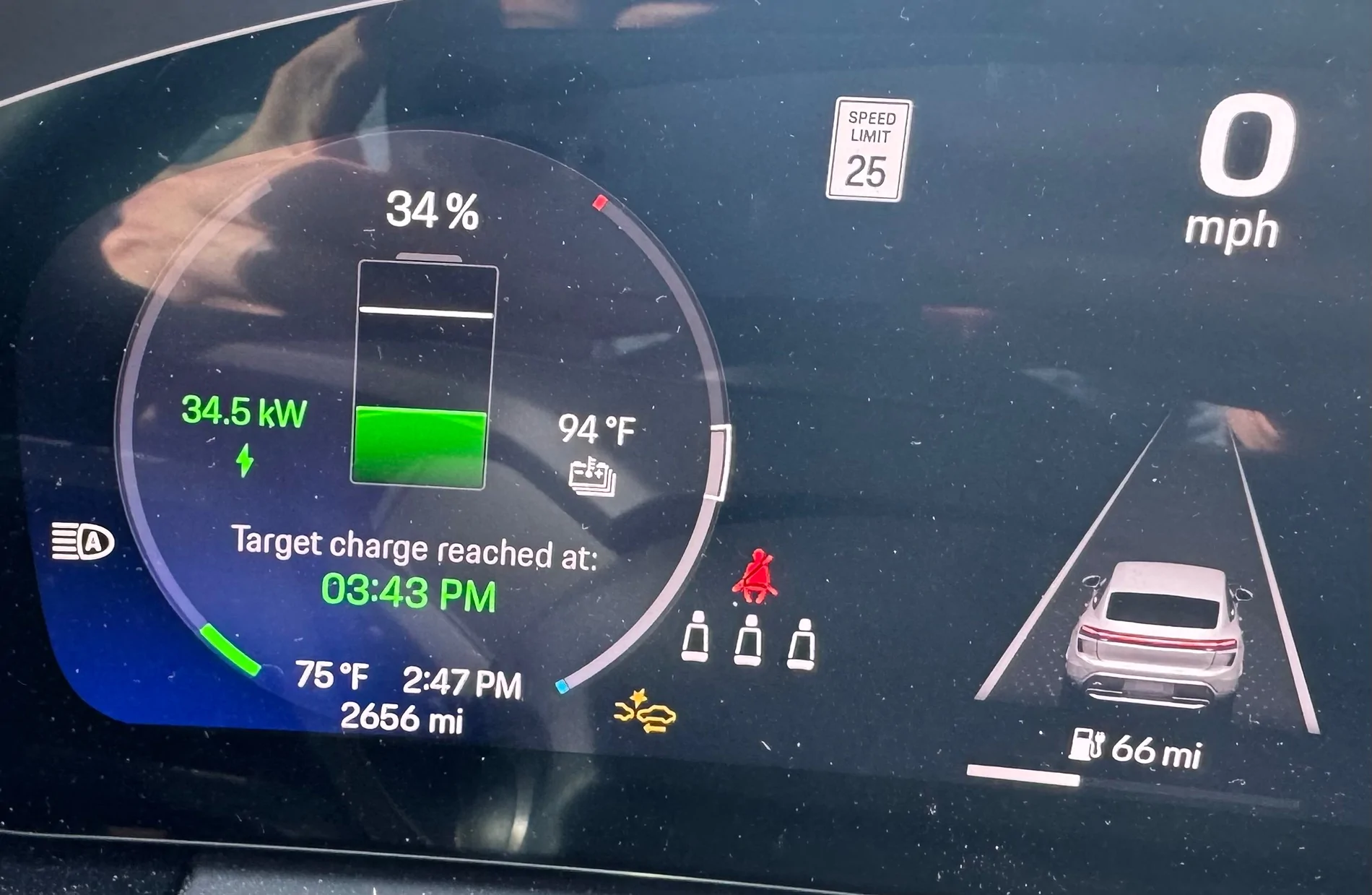

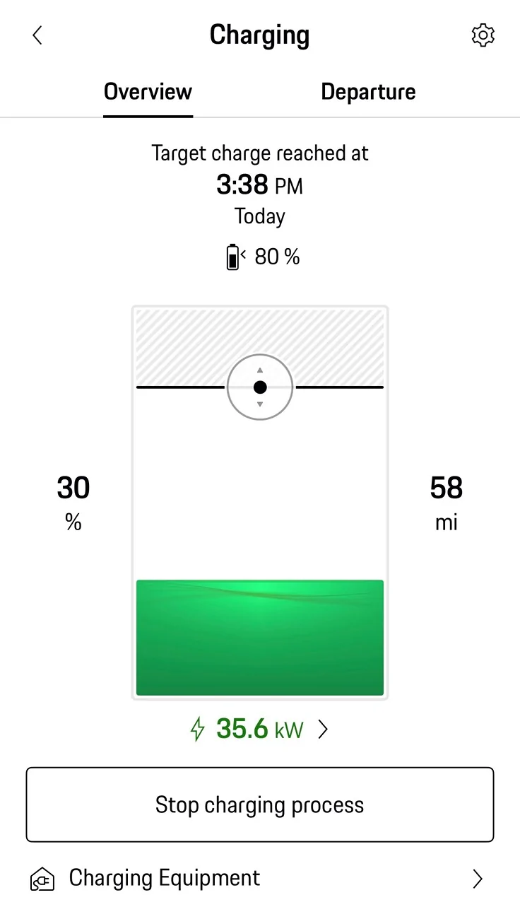

Charging Speed at EA: Charged for five minutes. Speed never increased past 37kW.

First Charger at EVgo: Charged at 35-36kW.

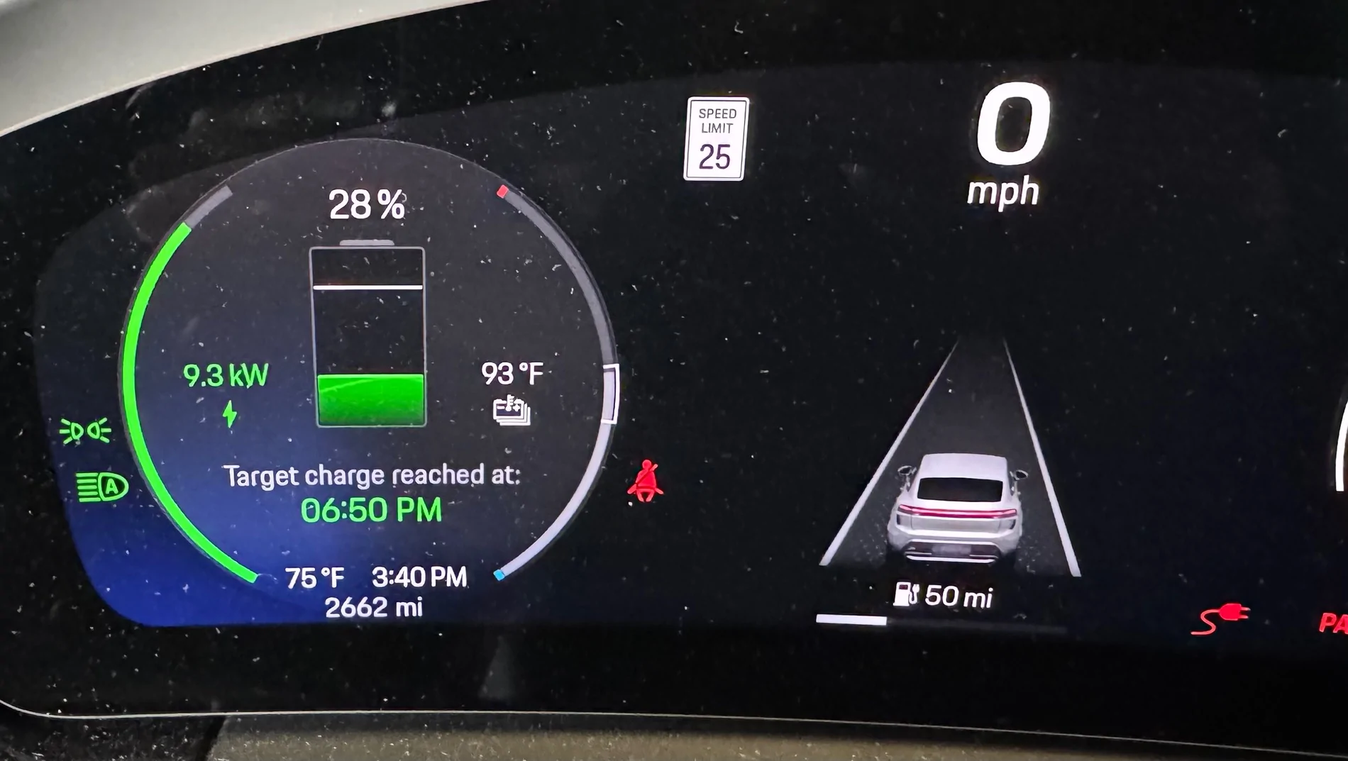

Charging on the home charger afterwards:
