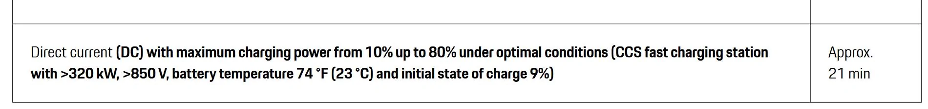

1. There are several variables that must be met in order to achieve maximum charge speeds assuming the charger is not broken and provides adequate charging power, and the variables are the following from the manual:
SoC: <10%
Charger Speed: >320kW

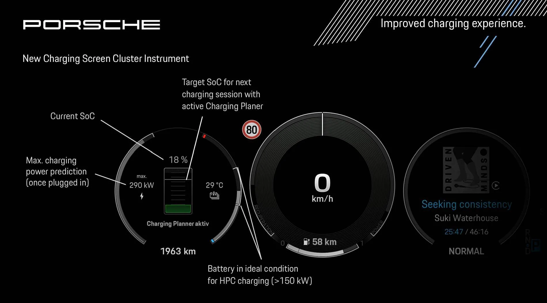

HV Battery Temp: 74F minimum and shown in the left tube with line bracket (on the right side) indicating optimal temp range to accept maximum charge. See graphic below that is from Taycan but it gives clear explanation of what you need to be looking for.
Electric Macan EV Slow Charging Macan 4 1736122874120-5v
2. The Charger may not be providing adequate speed as it may be throttled or broken.
3. Your onboard charger is bad.
This is from the Taycan refresh launch that would be helpful to you. The only thing that Macan EV does not support is the predicted charge speed on the left of the battery graphic.
Electric Macan EV Slow Charging Macan 4 1736123186208-m9
