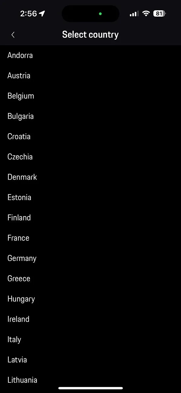

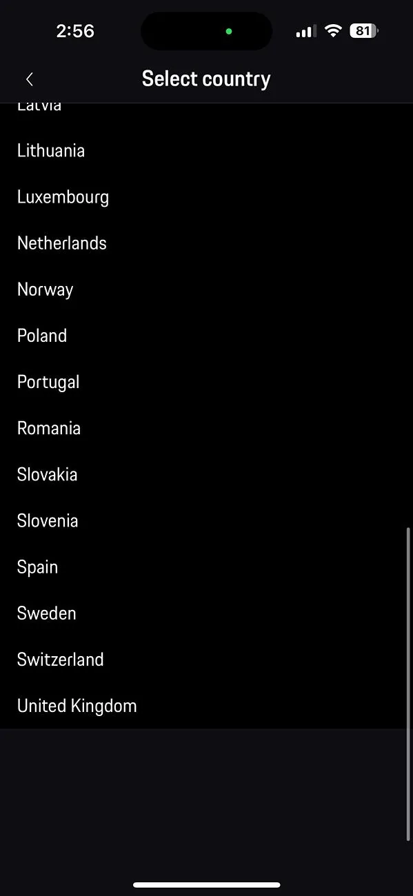

Tried to add the Porsche Mobile Charger but it didn’t have a QR code to scan. Tried to add it manually but the country list had only European countries and not the USA???
I am planning to email Porsche customer support to see whether they can fix it on their end.

I agree that it is pretty much useless. Regardless, I am planning to use the Tesla UWC as my wife has a Tesla MX. I posted it because I was surprised that the app only allows you to pick European countries and not the USA. Maybe my account is wrongly set as being in Europe on Porsche’s end? I doubt it, but it made me wonder…
please keep us informed because i would like to add mine as well...and i'm seeing the same issue... it says scan the quick card...but there isn't one
You need to perform the setup from the PMCC where you link your Porsche ID to the PMCC. Until this has been done the app won't know.
Your PMCC must be connected either to your phone as a local hotspot or to your home router to be configured.
When connected the app will give you charging history only.
Note also that the PMCC has a separate web interface to manage some features. You should have a white envelope with userids and passwords.
Do you have the Owner's manual as this will walk you through the steps.
In summary, read the manual and forget My Porsche App until your PMCC is fully setup, online and registered to your Porsche ID. Once done you will then see it in the app.
