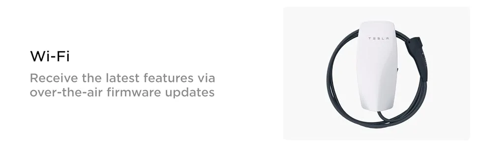

I was thinking about buying the tesla charger.
What do you think?
I have been charging the Macan sinds september now with the Tesla Wall Connector Gen 3 without any issues. I get the same 11kw I got when I charged my M3.
I also started charging with a schedule that I have set in the app, starting at 02:00 and ending at 05:00. That also works, what I do notice is that when I plug it in it charges for a few seconds and then it stops. I think that is because the Macan is trying to figure out what the charger can provide. It then resumes at 02:00 and stops at 05:00 or when it reaches the 80% level.
What I forget to set was the toggle for location, I've done that now. I wonder if it will remember that this is my home charger so it doesn't need that initial couple of seconds of charge to determine the ability of the charger.

Oh, and another thing with the TWC, you have to open it up to all EV's.
That's because the TWC has three settings:
  1. Only your Tesla, identified with the VIN
  2. Only all Tesla's
  3. All EV's.
So if your charging location is accessible to the public you might want to think about that.
