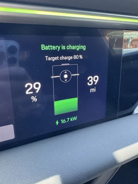

When I started to charge at the fast 350kW charger at EA, I was only pulling between 16-20kW max. There was no one else charging at this EA facility, and I tried three different chargers, but all were pulling in the same low <20kW range.
Electric Macan EV Continuing Battery and Charging Issues - 2025 Macan 4 IMG_3715
Above: 29% battery showing only 39 mile range.

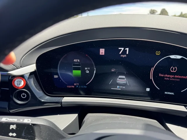

A few miles into that second leg of the trip, the battery % and range continued to drop significantly. I lost 12% battery in less than five miles.
Electric Macan EV Continuing Battery and Charging Issues - 2025 Macan 4 IMG_3720
Above: 48% battery and 59 mile range after charging and on the way to my second meeting.

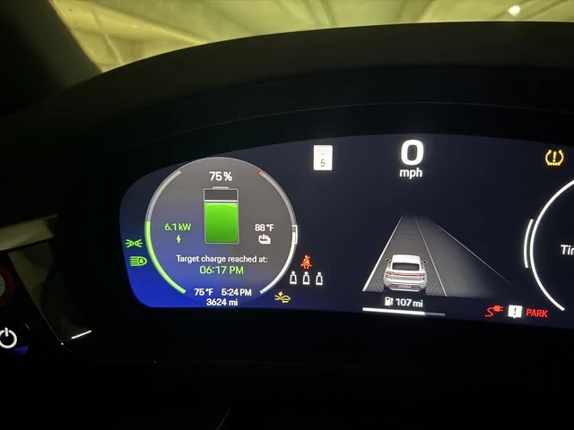

I let the battery charge at the slow charger to 75% (note only 107 mile range at 75% battery above), and then made my way to dinner in Palo Alto where I parked in a public garage with slow chargers.

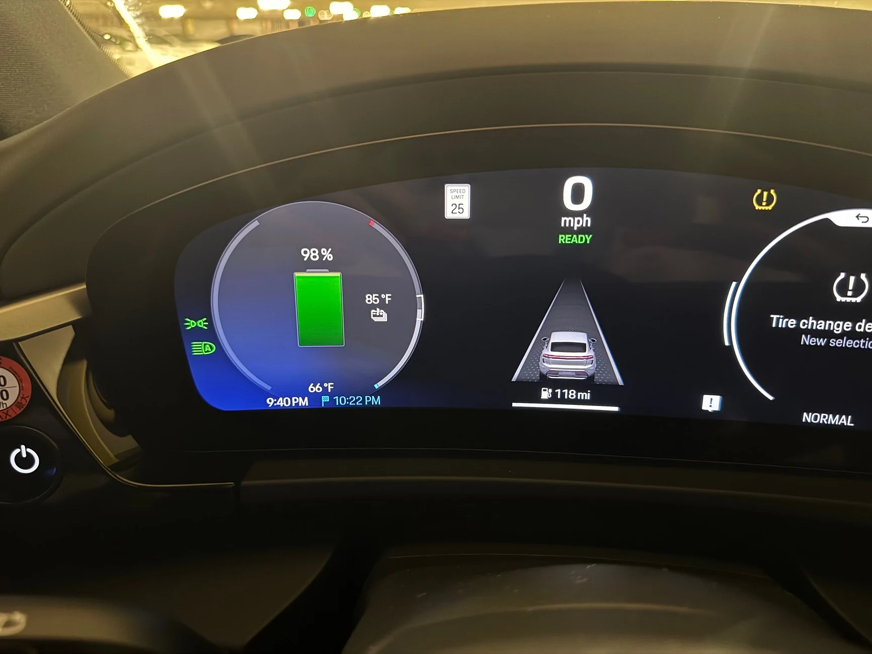

After dinner the app notification indicated that the car had fully charged to "100%" as programmed. When I got to the car (above) the battery was at 98% and showing a 118 mile range.
By the time I got home the battery had dropped to 73% with a 105 mile range; so not as severe a degrading as on the trip down.

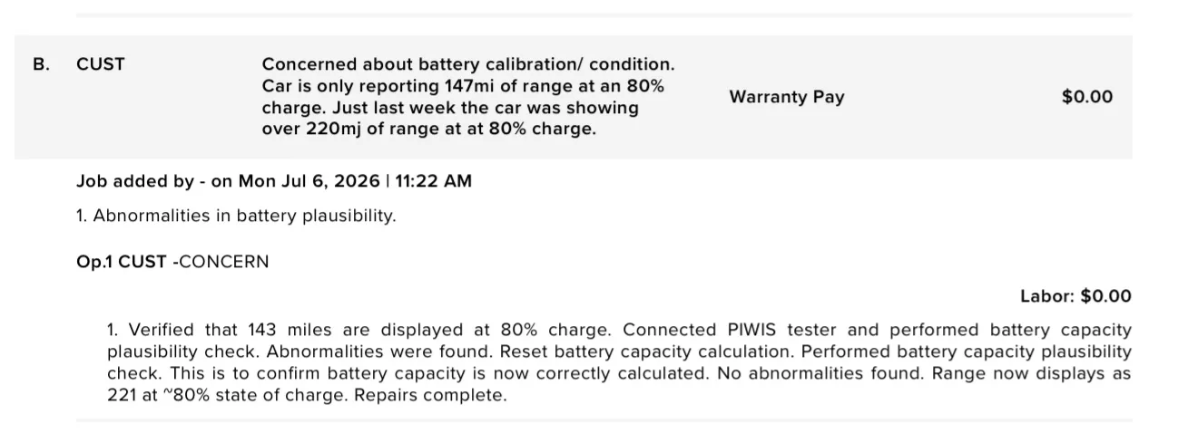

There seems to be a serious bug with battery capacity and range calculation impacting Macan EV right now. Similar issue here - commute regularly from San Francisco to Cupertino and back for work. Normally I use about 20% of battery each way, 40% of charge total. A couple of weeks ago on my way home I started getting low battery warnings and noticed that both my battery percentage and predicted range were extremely low. When I got home and charged to my usual 80% it was only showing 147 miles of range.
I tried doing what other have suggested - draining the battery low, then charging to 100, then draining and recharging again and nothing fixed it, so I took it into service. Apparently they ran some diagnostics and found some abnormalities that required them to do a reset or reprogramming of some sort. So far, so good after that service. They also installed the latest software update while it was there. Attaching a section from the service invoice. Unfortunately it looks like you’ll need to take it in for the fix, but fortunately it was relatively quick.
