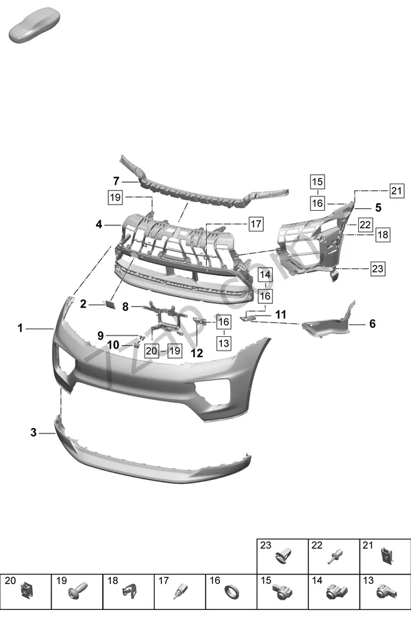

Note, it doesn't show any hardware fasteners for the lip itself...

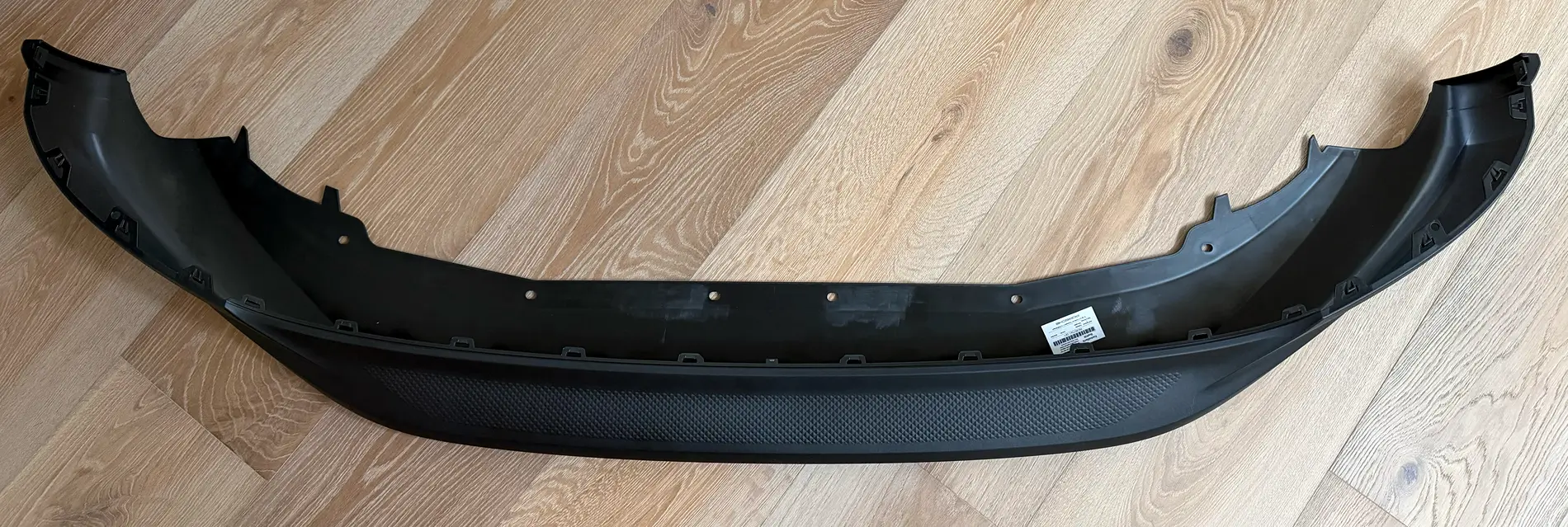

One online parts store honored the original quoted shipping rate so I finally obtained it.
In case anyone wants to see the part:

My first attempt trying to remove the old one failed miserably. Those tabs (18 total) are sort of like 1-way insert into a slot opening that's barely big enough for the tab and locked in place, and particularly more difficult for the ones on the ends. Might be easier to release from the inside than prying from the outside. If that's the case I'd need a lift to remove the underbody cover... or just pay a body shop to do it.
The bottom 6 screws were also challenging because while they are just torx, they have been shaved pretty badly from scrapings.

My next plan is to cut / drill out the bottom to access the tabs. It’s getting replaced with a new one I don’t need the old damaged one intact.
