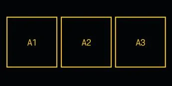

In user defined view, various display content such as driving assistance, compass, speed display, traffic signs, etc., can be freely combined in three fields (Fig. 1). Temporary messages such as Telephone calls may temporarily overlay area.
Electric Macan EV Heads up display issue img03af2e4c4d6e99058d24c0b3735a4b83_1_PNG150
Fig. 1 Head-up display areas
