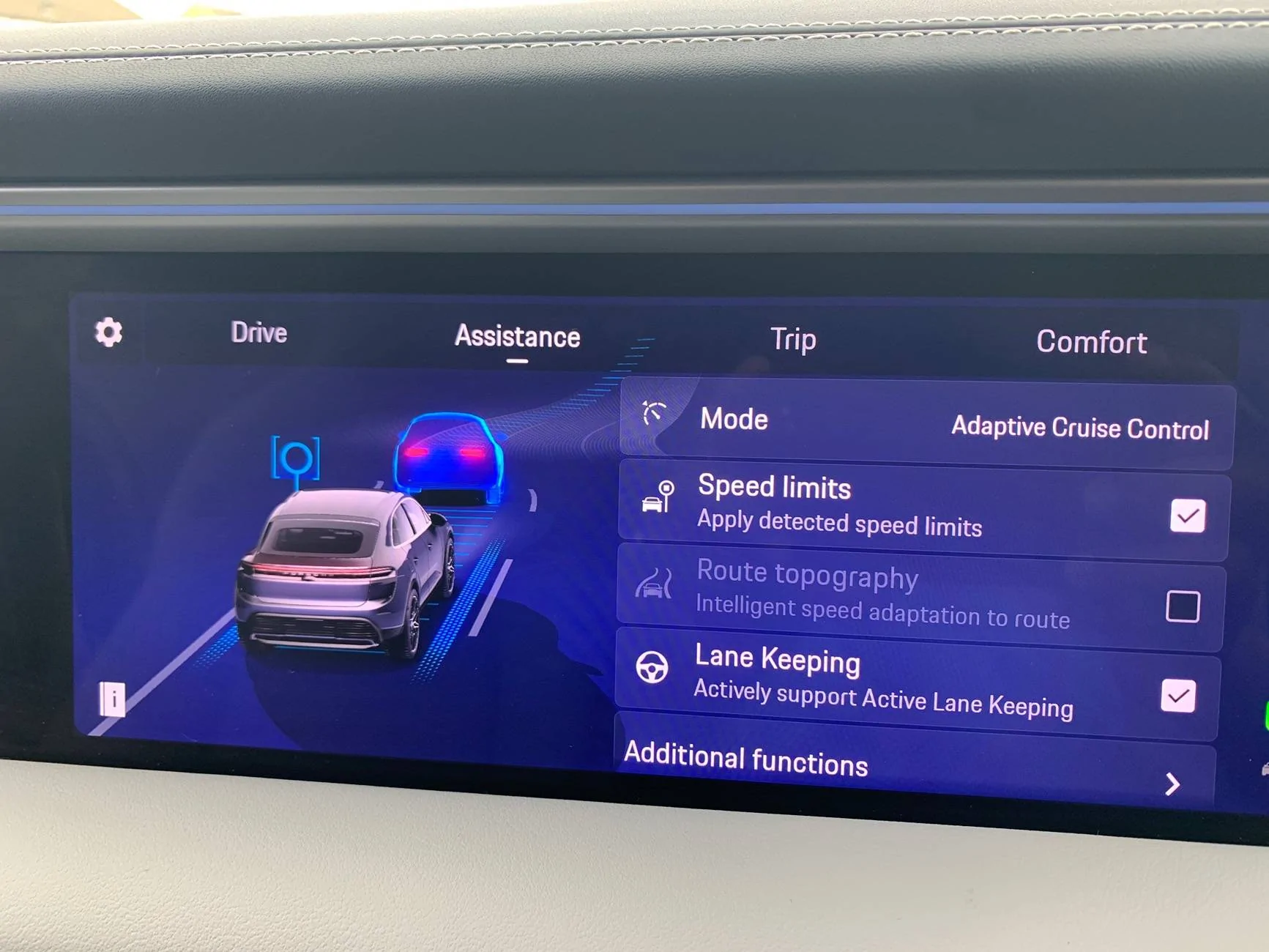

I don’t see this. I have ACC, Limiter, Porsche Hill Control and Off.
In the PCM with ACC as the mode I have
Speed limits apply detected
Route topography
Lane keeping
All are ticked.
On the drive, the car didn’t apply detected speed limits (it did detect them it just didn’t alter anything)

Speed limits apply detected-
This should show a sub menu- Manual/Auto.
Will send some screenshots next time I am in the car.

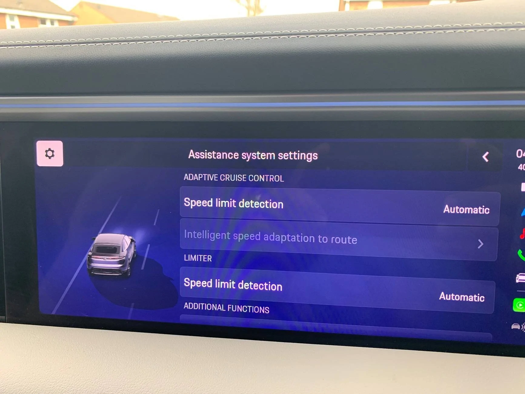

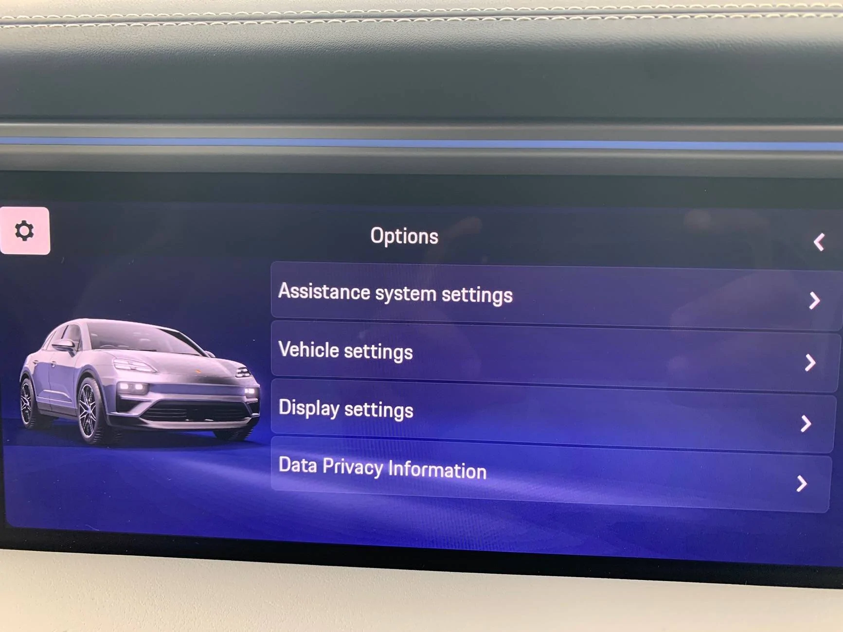

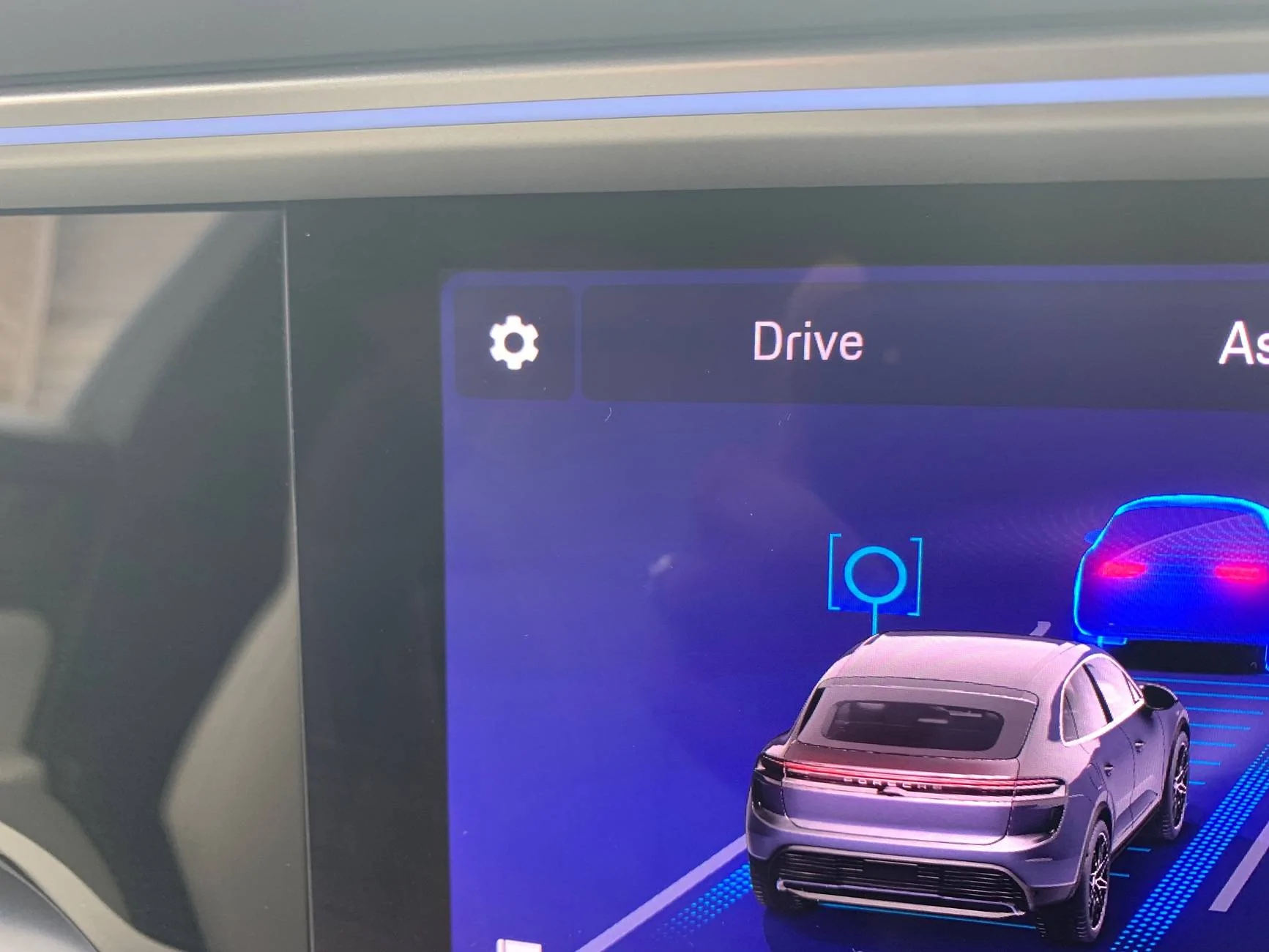

See screenshots. Not very intuitive. Need to click on the circle thing for the sub menu.
Electric Macan EV Innodrive in UK, auto speed? IMG_6357
Electric Macan EV Innodrive in UK, auto speed? IMG_6358
Electric Macan EV Innodrive in UK, auto speed? IMG_6359
Electric Macan EV Innodrive in UK, auto speed? IMG_6360

Blimey. OK hadn’t even occurred to me the blue sign was anything other than a pretty visualisation. Will give it a try - thank you.
