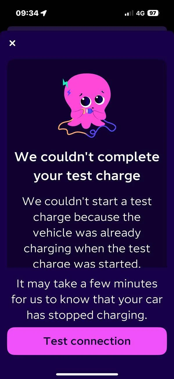

Disabled the charging password, but IOG still can’t communicate with my Macan after the first pause.
I’ve reached out to Octopus who have suggested adding the Andersen A3 as the device rather than the car.
I’ll try that next.

Update: Octopus adjusted my profile to allow IOG to control the Andersen A3 to charge the Macan.
Pleased to report it’s working — charging now resumes after an IOG pause for the first time since I got the car.
