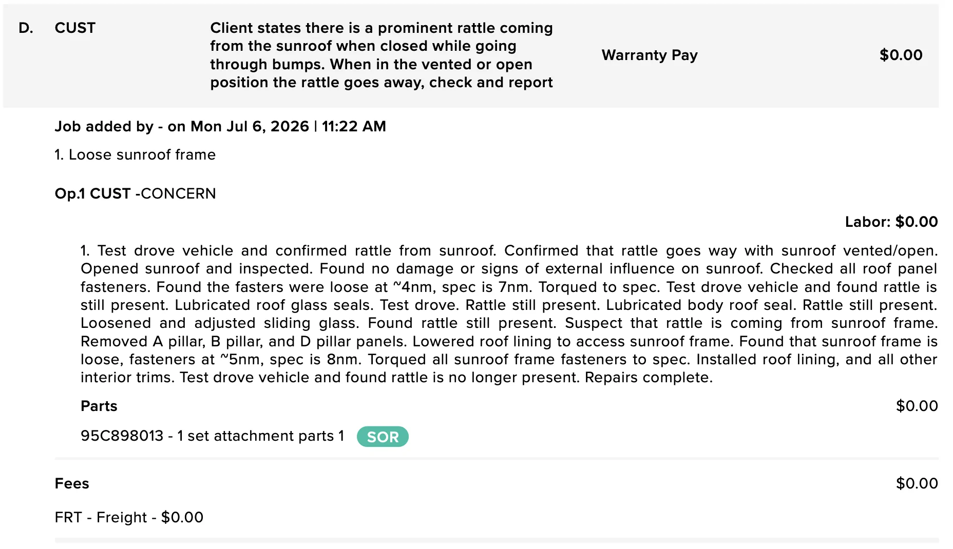

It's an easy fix, take it to the dealer. I had this problem and it was permanently fixed.

What was the the problem and the fix that helped you?

Same as yours - roof rattles when closed, no roof rattles when open.
Don't know what the fix was.
