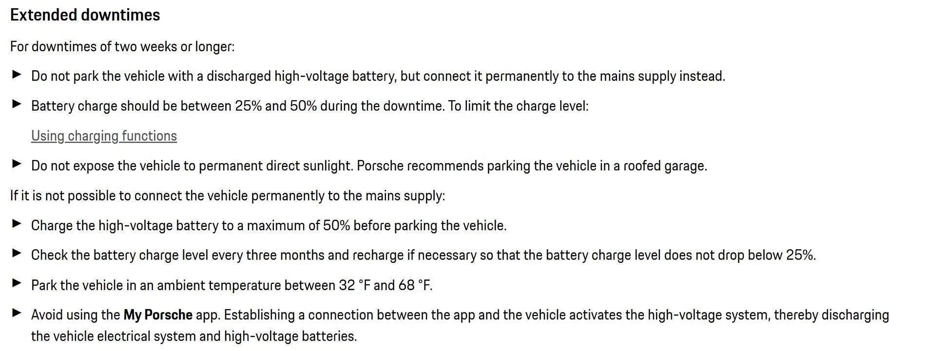

Based on what I'm seeing here, seems the genius engineers over at Porsche designed it so the 12V is only charged if the car is on? Otherwise you have to keep it plugged into a battery maintainer?
SergeyIndy said:

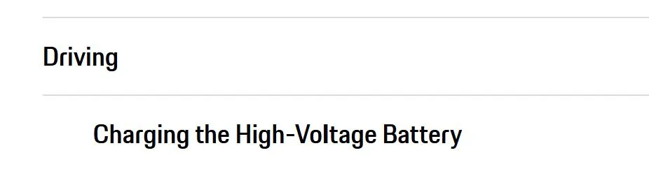

This is what the manual says, however, this does not give me assurances that 12v will not go flat without a trickle charger:
Under
Electric Macan EV Problem with the air conditioner and battery cooling 1738462410078-gh-jpg
Electric Macan EV Problem with the air conditioner and battery cooling 1738462236400-9r-jpg
Yeah I stupidly assumed keeping the car plugged in meant the car will ensure the 12V is also kept charged.. but it doesn't appear to be the case?

A friend of mine has a 2024 Taycan that she got for her birthday last year. They went on a trip for a little over three weeks and the car sat at home, not plugged into the charger.
I picked them up at the airport when they got back, using her car. I had no trouble unlocking the car and the HV battery had enough SoC for the pickup (though I don’t know how much it lost during the time it sat idle). So the 12V battery dying in a week is not normal.
I wonder if in the instances where this happens (besides the battery itself being bad) people aren’t following the recommendation to keep the key(s) away from the vehicle so it can go to sleep.
