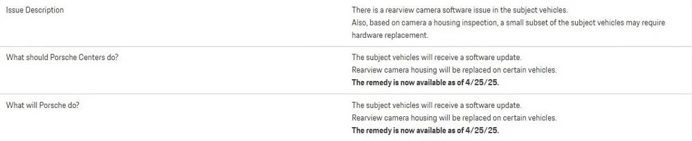

The recall notice https://static.nhtsa.gov/odi/rcl/2025/RCAK-25V220-7737.pdf describes it as affecting:
Components:
BACK OVER PREVENTION: SENSING SYSTEM: CAMERA
BACK OVER PREVENTION:SOFTWARE
That seems rather pretentious language for a 'fuzzy rear camera image'.

There have been many posts about this on Rennlist - the posts there also say cars are being held in the ports until the update and replacement cameras are available - today someone posted that all is now available -

Ok here is the update
1. Camara inspected for bonding issue. No issues found
2. rare cases when camera cannot be activated when park assist in turned on due to software error. This issue is accompanied by yellow or red warning "vehicle electrical system" error.
2a. customer satisfaction fix: Optimized the High voltage heater (has a back up heat in the heater area) that can sometimes cause an odour
2b. Optimized battery capacity calculations to improve range, charging power and SoC display.
2c. Optimized diagnosis to detect adhesive HV protectors' which can lead the HV System to shutting down or a charging process being disrupted.
3. rare cases when the vehicle cannot be started or unlocked by the key fob.
In my case I have never had any of the above issues but looks like I might not in the future ;).
In case your interested : These fixes involved the Main control unit gateway, the main control unit for body electronics and the high voltage battery control unit.

Sure, all of this took about five hours in the shop so basically drop off at 10 AM. Pick up at three.

Interesting! I tried to book an appointment for the recall online and received a message that yes, the car was being recalled but they don't have parts available. Thankfully I haven't had any of the issues being checked so I'll just hold for now and see how things go into the summer.
