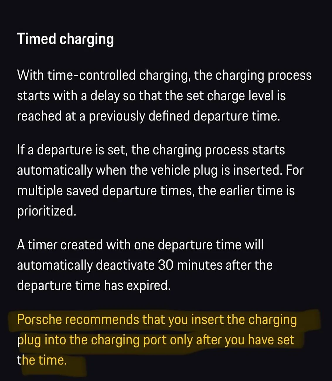

Mine works fine but I did have 2 charges that failed as I didn’t follow the required order of things. In my case, I set the departure time for 7am before the car is connected and it works. The App says charging paused, then I know it will work.
It has failed when I had the car connected, optimised charging selected but no departure. Setting the departure after connection doesn’t work in my case.

It seems my issue is with the charger. The car/app wants to start charging at the time it thinks appropriate that why it shows Initialing but it can't draw power from the charger unless I manually tell the charger to start. I might just have to use my charger's schedule to charge within a specific time now (no more Automatic optimize in myPorsche app).
