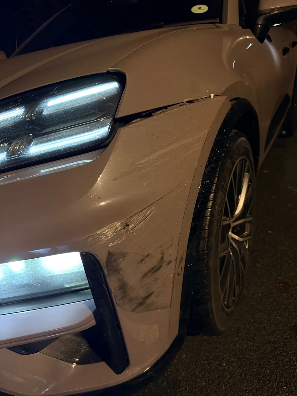

Those who have been on this forum for a while know I have done nothing but complain about the random emergency stops my car has performed for no apparent reason, all the warnings that kept popping up, the attempts to force me into oncoming traffic that the lane assist had done, and as very unfortunately evidenced last December - the shoddy safety systems in general which completely failed to identify let alone avert a collision at 25 ish mph. The collision avoidance nor the emergency braking kicked in, and the sound recording on my Dashcam doesn’t even pick up the ping from an alert notification (it all happened too quickly for me to say whether it did or didn’t by sight)
Would not surprise me one bit if you were having similar issues with any of the road monitoring system performance as Porsche themselves don’t appear to know what’s what with it.
After my bump, once the body shop had done their bit on the bumper and wing which took 9 weeks because of parts shortages with Porsche and other issues, they couldn’t get the safety systems back online properly so sent it to Porsche who did the large software update which should have fixed a lot of the general issues, and supposedly resolved the systems errors caused my the crash. They had not. So back it went to Porsche and 3 weeks of investigations and a complete change of camera array later I picked it up on Wednesday last week (a total of 12 weeks post bump!). I don’t appear to be getting all of the false warning about potential crashes now, but I’m still getting warnings to take over the driving when I try to use the Innodrive, so something clearly still isn’t right with the whole road monitoring system.
