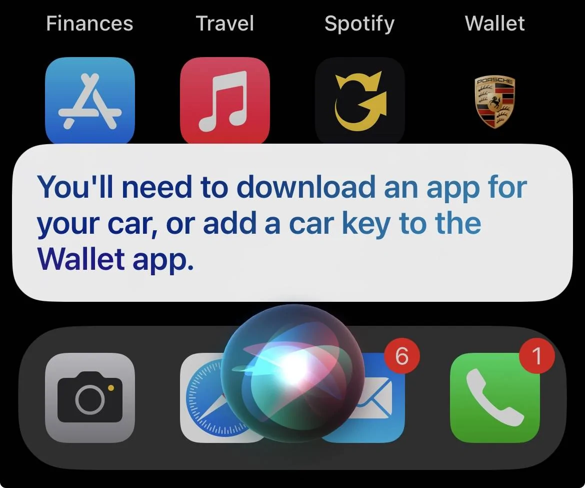

I am getting this message when I ask Siri to execute the climatization shortcut
Did you create the shortcut?
If so, you can invoke it with Siri by saying "Hey Siri, [insert name of shortcut here]"
If not, you'll need to create the shortcut using the steps I outline above.
Yes I made the shortcut and renamed it.
That's the message I get.

Hmmm... Not sure what to tell you. A few things to try...
You may want to make sure you've got Siri enabled for the My Porsche app. Here's how to do that... Open the "Settings" app>scroll to bottom and select "Apps">scroll to and select "My Porsche" app>select "Apple Intelligence & Siri">turn all the toggles to On.
Next, make sure the shortcut is enabled to access the My Porsche app properly. To do that... Open the Shortcuts app and open the shortcut you created to edit it. At the bottom of the screen, you'll see an "i" with a circle around it. Click on that. Go to the "Privacy" tab and make sure "Allow this shortcut to access My Porsche" is ON.
I hope this works for you.
