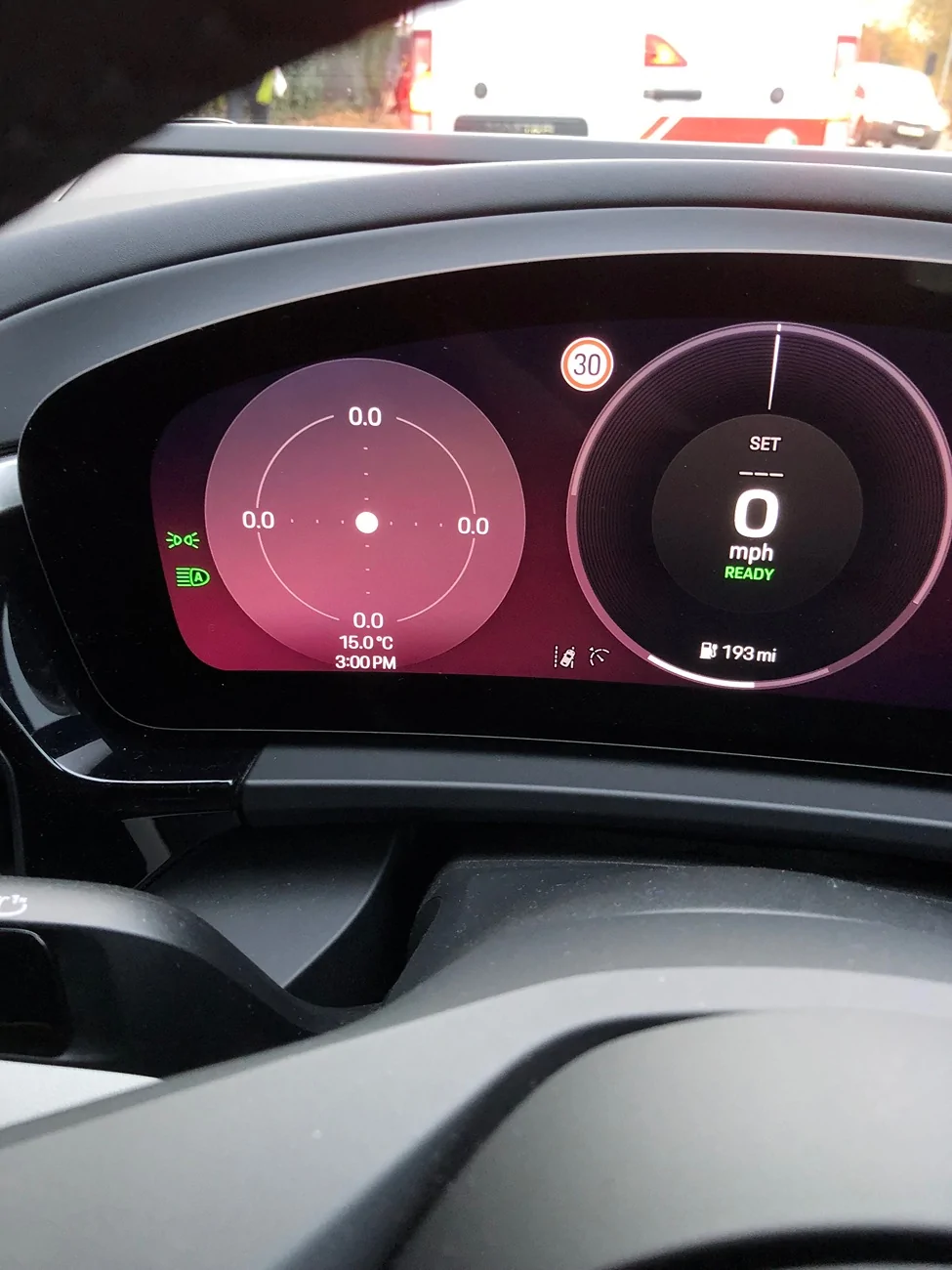

Hello! I took my Macan EV to local Porsche dealership today for a new tyre due to a puncture, the second in 10 days!! No problems, but driving home I noticed this on the dashboard screen. As I drive faster in moves! No idea what it is telling me!! Can anyone tell me what it means and how I get rid of it please. By the way I am a lady!
Electric Macan EV What’s this on my dashboard IMG_3970

Since I had ChatGPT open, I copied the image and text to see what I would get. I'm sharing here a reply. Mostly accurate....
What the Display Shows
That circular screen with a dot in the center and “0.0” values around it is your G-force meter, which measures acceleration, braking, and cornering forces.
Here’s how to interpret it:
  • The center dot = your car at rest (0.0 g in every direction).
  • As you accelerate, the dot moves backward (showing forward G-force).
  • As you brake, it moves forward.
  • In cornering, it moves sideways toward the direction of the turn.
  • The numerical readouts (0.0 / 0.0 g) show your real-time longitudinal and lateral G-forces.
So when you said it “moves as I drive faster” — that’s exactly what it’s doing: tracking how the car’s weight shifts during acceleration, braking, and turns.
⚙ Why It Appeared
It likely came on because:
  • You accidentally switched to the “Sport Displays” or “Performance” view in the instrument cluster,
    or
  • The system defaulted to this view after the service visit (common when the vehicle settings reset).
✅ How to Remove or Change It
You can easily go back to your preferred display:
  1. On the right-hand steering-wheel buttons, press the “View” or roller wheel to change display modes.
  2. Scroll or toggle until you see your usual speedometer, navigation map, or trip info.
  3. Alternatively, in the main menu:
    Car → Display → Instrument Cluster → View
    …then choose another view (for example “Classic,” “Map,” or “Driver Assistance”).
Once you exit the Sport Display, the G-meter will disappear.
💡 Quick Tip
The G-meter is fun to watch in Sport or Sport+ mode, especially on twisty roads — it shows how much grip and acceleration you’re generating. But for everyday driving, switching back to the Classic or Navigation layout is less distracting.

That's the G-force meter, shows how quickly you are accelerating in each direction. Blob in the middle represents a top-down view of the car. Fun to watch on the track, irrelevant on the road.
To get rid of it, see the section on "Operating Multifunction Steering Wheel" in the manual (https://manual.porsche.com/#/wpi/XA..._US/topic/id/fe35882db39971408d24c0b34de57d05).
Basically press the right-most button on the steering wheel until the border appears around the left "tube" in the instrument panel. Then use the right-hand scroll wheel to select different screens.

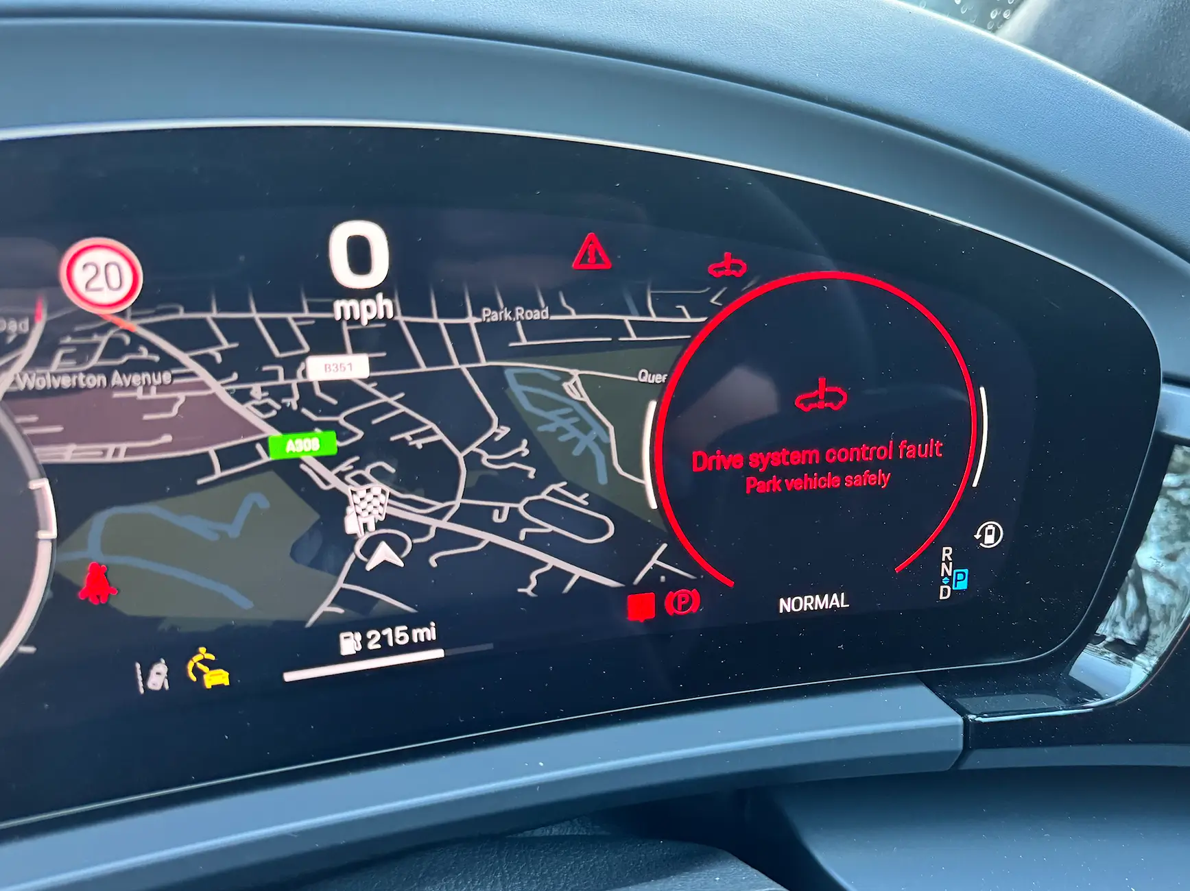

That's amazing. Can you do this with this for fun please?
Electric Macan EV What’s this on my dashboard Screenshot 2025-11-06 at 11.07.01

BTW, Anyone can do the same on https://chatgpt.com/
Disclosure: Keep in mind this is AI answering, not a Porsche tech.
However, in this case, locking the car and walking away for 15-20min is what has cleared such errors for me in the past...
The red warning message on your Porsche Macan EV display —
“Drive system control fault — Park vehicle safely”
— indicates a serious fault in the high-voltage drive system or control electronics.
Here’s what it means and what to do next:
⚠ What the Warning Means
This alert is generated by the powertrain control module (PCM) when it detects a critical issue related to one or more of the following:
  • High-voltage battery management system (BMS)
  • Inverter or electric motor control module
  • Cooling or power distribution fault in the drive system
  • Software or communication error between drivetrain ECUs
Essentially, the vehicle’s main propulsion or regenerative braking system may not be functioning correctly, which can cause reduced power, limp mode, or inability to drive.
🧰 Immediate Steps
  1. Do not continue driving if performance is limited or unusual noises occur.
    Safely pull over and put the car in Park (“P”).
  2. Turn the vehicle off completely, wait a few minutes, and restart — sometimes transient control faults clear if caused by voltage or communication spikes.
  3. If the message returns, do not attempt to drive long distances. Contact Porsche Roadside Assistance or your local Porsche dealer (in your case, Porsche Barrington) for diagnosis.
  4. Avoid disconnecting the 12 V battery yourself — doing so can trigger further HV safety locks.
🧩 Common Causes Reported on the Macan EV
  • Fault in high-voltage coolant circulation pump
  • Malfunction in power electronics module (inverter)
  • Temporary communication issue after charging session
  • Software calibration mismatch fixed via dealer software update
🧾 What Porsche Technicians Will Do
At the service center, they will:
  • Run PIWIS diagnostic scan for error codes like P0AA1, P1A10, P0E10, etc.
  • Check isolation resistance of the HV battery and motor.
  • Apply any available software updates or recall patches (there have been recent service campaigns on early Macan EV builds related to drivetrain control logic).

Good heavens, I would never have sorted that on my own. Thank you so much. I will sort it tomorrow when I used to it the car. Anything else I should know about, ejector seat maybe? Thank you again.
lol I love the "i am a lady" part
well I am a lady, the only g force I know about would be Tom Cruise in Too Gun!!!
Response from ChatGPT - Turn it off and on again.
That is how most of these stupid warning signs are resolved. I had a rear differential fault the other morning that magically resolved itself after that most technical of fixes lol
