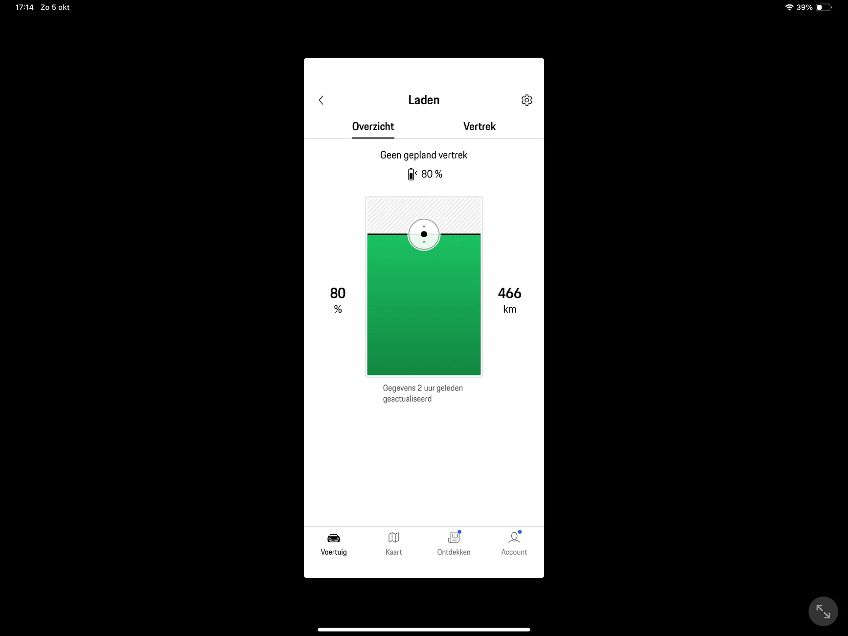

What's your estimated range with 100% SoC?
586
354
The App will give you the efficiency from charging, total to date and recent trip.

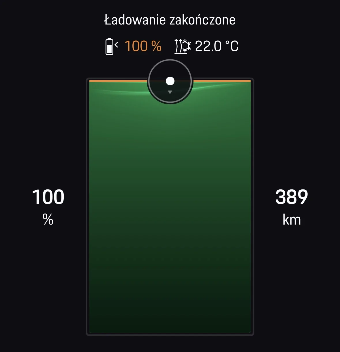

Mine at the moment shows 389 kms and it's getting lower and lower the longer I use the car ;)
Electricity is not measured in distance, but kWh, at the scale of an EV.
The range shown is just an estimate based on several factors. The main ones are:
  • Amount of electricity in the battery: In a perfect world, the same amount of electricity would result in the same range. But all batteries degrade over time, and often faster the first year or so. Whether the range reduction shown is real capacity loss depends on how Porsche manages the buffer they built into the battery. They could be maintaining some top buffer, which means some of the range loss you see is real reduction in battery capacity
  • The current environment conditions, like how cold the surroundings are, as another commenter has pointed out
  • Your recent efficiency, affected by the temperate, wind, elevation gain, and your driving style
Ultimately, the range estimate is just that, an estimate.
After driving multiple electric cars, my wife's and mine, for several years, I've decided the range estimate is a guess not worth paying attention to. When it really matters like on a road trip, use the built-in trip planner, which on the Macan is pretty accurate, and charge where it suggests you charge.
For daily driving, just pay attention to the battery percentage, and charge when it gets below whatever your comfort threshold is.

You are correct, I was curious because it reflects this range based on your long term average consumption. It does not predict the weather for you next trip or how fast you'll go but it gives you an estimate for your particular driving style and conditions. I would also assume it reflects the SoH of you battery as it should calculate this based on the usable kWh and not just the %SoC.
In my case it's spot on - i'm mostly driving on highways at constant high speed, do a lot of fast DC charging, the battery is often warm. I also noticed it's slowly but surely decreases over time which makes me wonder why.

Every EV battery will lose some capacity over time. As far as I know, every manufacturer calculates SOC percentage based on the current capacity. That's what I was referring to in my first point. So, 100% of a new Macan is ~95kWh (100% =95 kWh). Maybe after a year, the battery has lost 5kWh of capacity (5.25%). The SOC on the display will still show 100% when the battery is charged as much as it can be now. (Now, 100% = 90kWh.)
So, even if all other variables are equal, 100% of a new Macan will guess the range based on 95kWh, while that hypothetical 1-year old Macan will guess the range at 100% based on 90kWh.
Natural battery degradation may be why you are noticing a downward trend in your estimated range.
