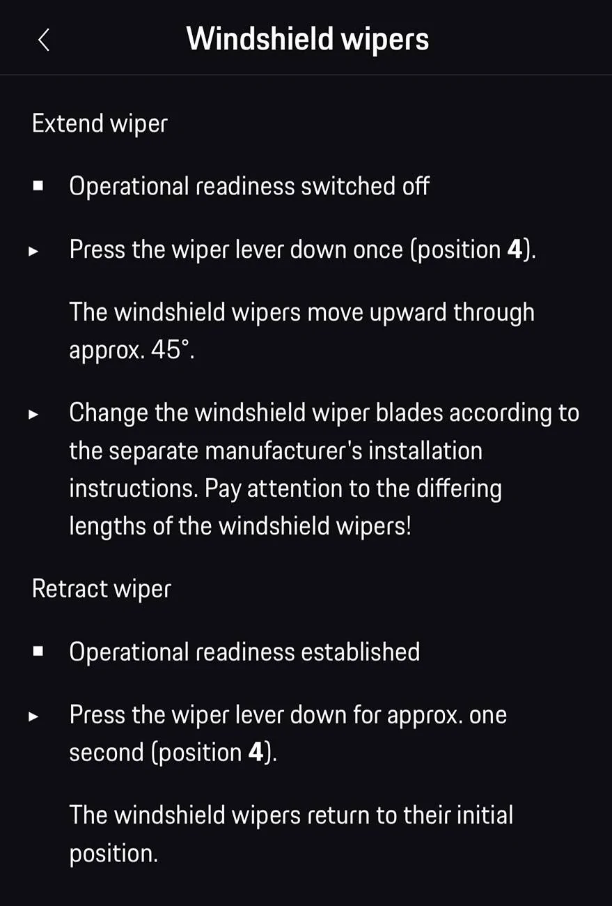

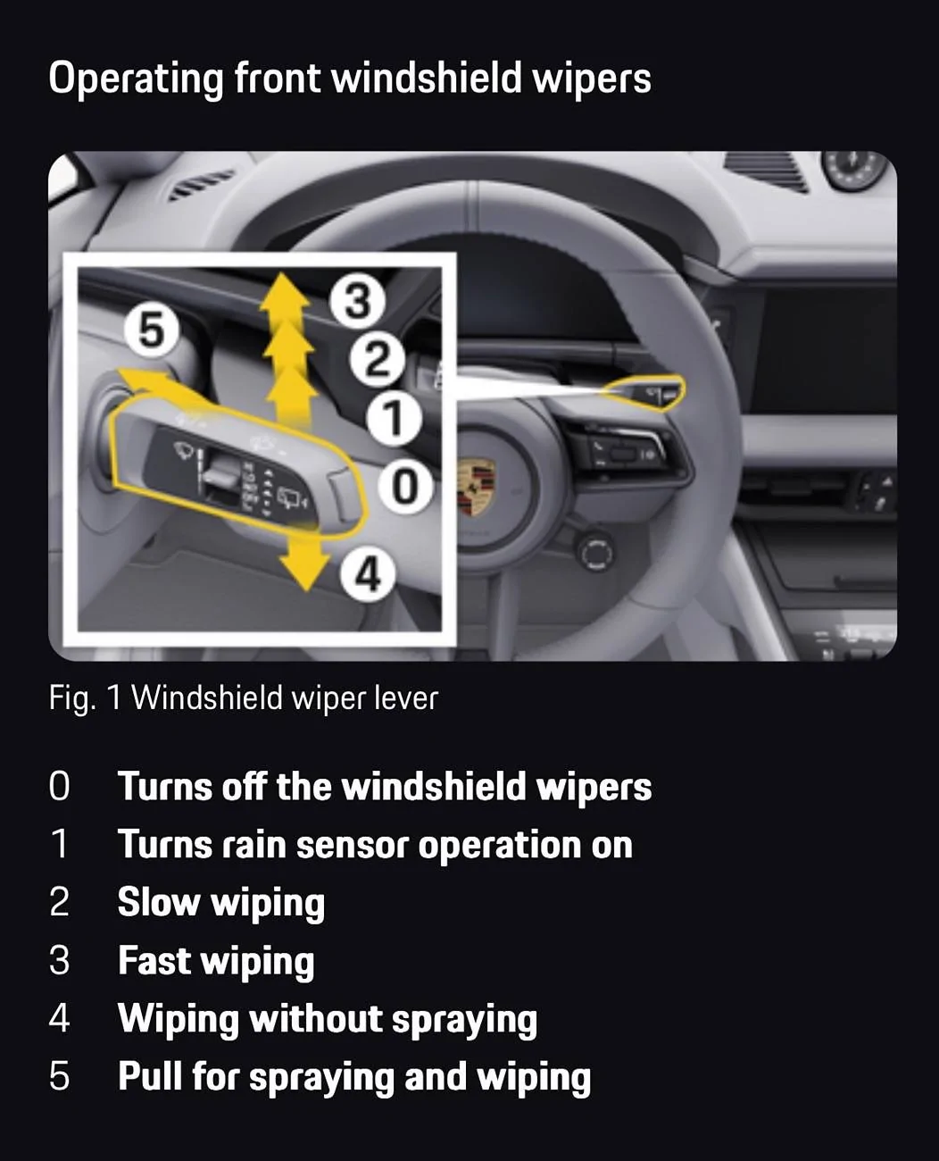

Macan EV, BMW X6, Tesla MX
I lifted my windshield wipers to clean the windshield and later realized that there isn't enough clearance to lift the wipers without them resting against the edge of the hood. This happened with the wiper on the driver side. In my case, this tore up the edge of the PPF and I had to take it back into the PPF shop to fix it (by cutting off the edge of the PPF so was torn up).
Has anyone else had this issue without enough clearance for the wiper? Is there some way to lift the wipers to avoid this issue?
Electric Macan EV Windshield wipers scuffing hood / PPF when lifted IMG_7752

Thanks - when it says push the wiper lever down, does that refer to the full stalk?

It never ceases to amaze me how few people read the manual of their vehicle, or google their issues.
