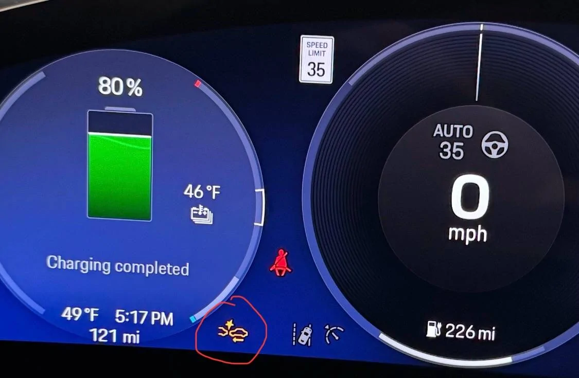

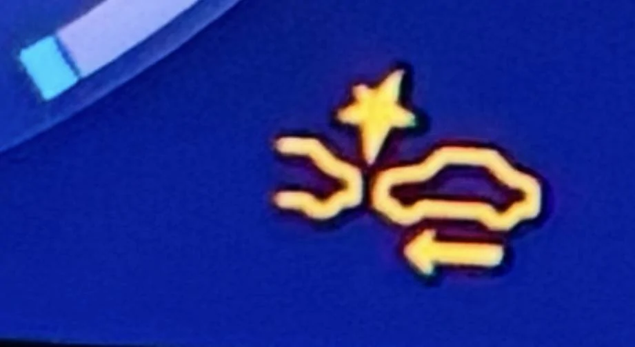

I frequently have this warning light appear when I turn on my 4S (see photos below). It usually goes away after a minute or two but occasionally stays lit while driving.
What does this symbol mean (since I couldn’t find it in the manual)? Does anyone else have this warning light illuminated?

Same thing on my 4S. It comes on every time I start the car and goes off within a minute, I assume it is the system calibrating / starting up.
It's a warning of following to closely to the car in front of you.....if you back off the light will go out.

Thanks for the clarification! Glad to know it’s a normal occurrence.
287
232
Thanks, Diego! It’s not always clear where to navigate within the online manual.
This page confirms Kal-El’s response that this symbol appears at startup until the Hazard and Brake Assist system is initialized.

Collision warning - driving too close to the car in front, sometimes false positive due to dirt / moisture on the sensors
