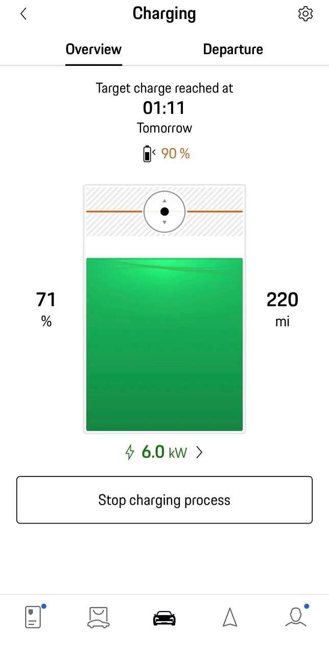

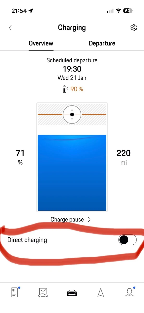

wellsmacan
Wells
Jan 3, 2026
Did you delete the departures via the app or in the car.
From Porsche tech support last year:
“Our technical team has identified the cause of the issue: if five departures are stored in the list and the preferred charging times option is activated for the last departure, the departure list can become corrupted. When this happens, scheduled functions are no longer adjustable in the app, even though immediate remote functions such as climate control and charging adjustments continue to work.
To restore full functionality, please delete the stored departures directly in your vehicle. Once the list has been cleared, the departure timers will be visible again in the app and scheduling can be adjusted as usual.”
Thank you for this. I have no scheduled departures in the vehicle and can see the timers, just oddly creates random departure timers and pauses the charge until I delete it when it appears or toggle direct charge.
wellsmacan
Wells
Jan 3, 2026
This is what I see and have to toggle the button to get the charging going again.
Electric Macan EV ⚡️ Home Charging Issues after Software Update? (Tracking Thread) IMG_2087
Electric Macan EV ⚡️ Home Charging Issues after Software Update? (Tracking Thread) IMG_2088
Flighty
Nov 12, 2024
45
Macan 4S, Previously Macan GTS, Audi RS4
I have not seen this direct charging toggle in my app, and I keep up to date with application updates!
