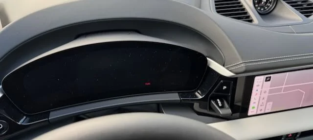

I dropped off mine this morning, as I am having another new (troubling) problem. I had used the DC charger, outside air temp was only 18c - but after charging, as soon as I stopped, and removed the DC charger (350kw) - the dash LCD went dark, and would not show anything except for warning lights - meaning, if you power cycled the car, no instrument display, but the self-test dash warning lights process still worked. it took about 1.5 hours but the instrument cluster started to work again. I took it the dealer so they could capture the codes. I did in fact take a video of the issue too.
There were no codes stored, other than the 'normal' communications issues they see on the bus they said.
I had to pull over, and grabbed q quick lunch, about 10 min on my drive to the dealer. locked the car, but could see it from where I was sitting. Just before returning the car, the hazards flashed similar (if not exactly like) when the door looks are locking/unlocking (I have prox detection on but was nowhere near close enough). I thought this was part of whatever was going on.
On returning the car, it was function normal again.
I've had this happen - only once so far. The HUD continued to work, so the car was drivable. Here's the photo I sent to my service advisor showing the complete lack of dials. The 'Park' text goes away when you put it in Drive. Note the PCM screen still works. This was not after a DC charge, as the EA site was full - I had planned to charge here, so pre-conditioned before this stop.
That is exactly the condition of my screens and systems (I don't have a HUD). The back of the cluster screen was pretty hot, but outside air temp was only 18c - and not even in the sun was in a shadow.
I also used pre-cond before charging. For the entire 30 min charge I was in the car doing emails, and no issues with the display until I got out, removed the DC charger and 10 seconds later was back in the car to a screen in that condition.
