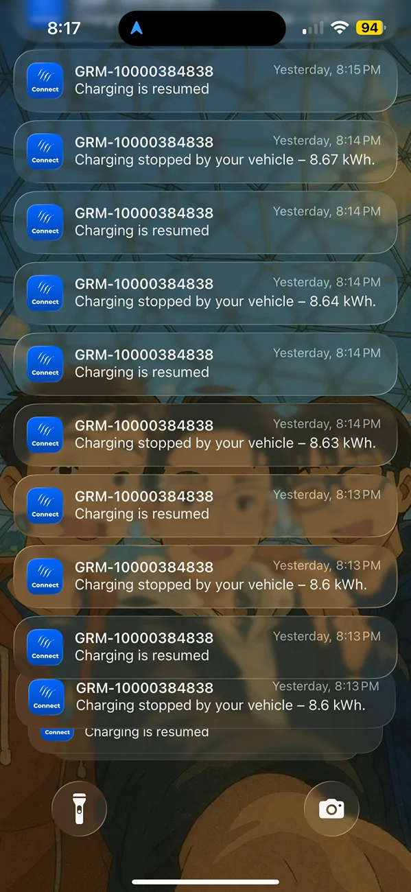

Update with mine. The car is charging at home, but now I keep having the "High Voltage System Error" pop up every morning. Plus, my grizzl-e app keeps sending notifications of the vehicle resuming and stopping charge like EVERY minute from the moment I plug my car in, with the optimized charging enabled. Apple devices cap notifications of applications to 100, so I had 100 of them two nights in a row.

Electric Macan EV ⚡️ Home Charging Issues after Software Update? (Tracking Thread) 1778090099000-ps

@lukine you should just get them to downgrade the onboard charger software. I had this and it works flawless now. I'm sure in the future they make have a version that doesn't break charging, but it was just not worth it at this point. the Super Chargers here are 70c a kw/w so charging at home is something that needs to be available all the time. at these charger rates at the electrify canada (up until recently) you would have been better off with a petro car (when you take into account operating costs and capital cost vs opportunity cost of that money in the market).
This downgrade for only the onboard charger was the only thing that 'fixed' the charger issues for me. I had the charger patter alerts you showed until the downgrade (not the whole car, just the charger software).
