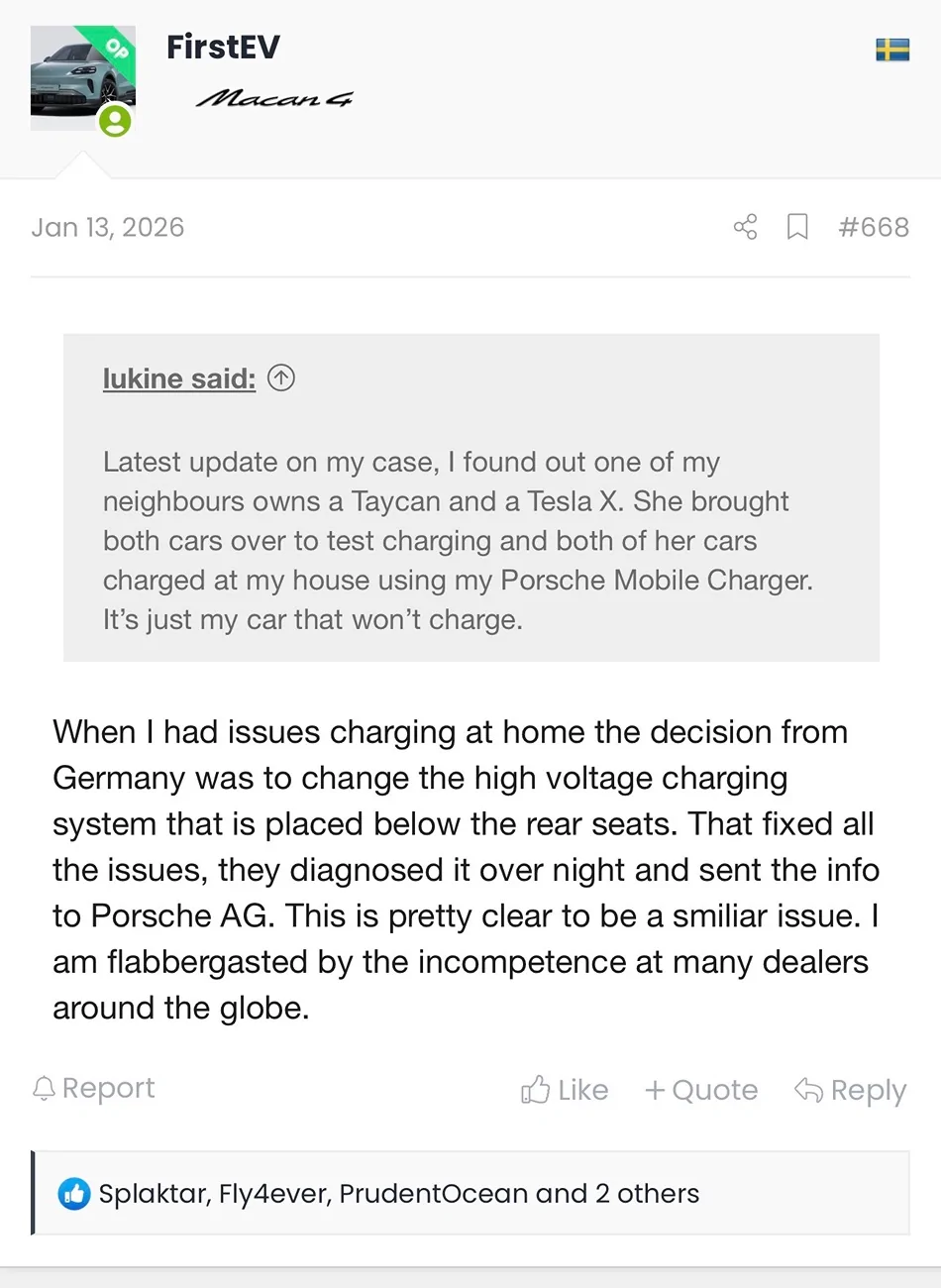

Anyway, my dealership is having issues updating my car. They’ve been trying for the last few days and it keeps failing. Now they’re thinking maybe they need to change the charge box. I wonder if this is the same issue as yours @FirstEV. They started another ticket to confirm with Germany if this the right course of action.
I really hope it’s the same issue, because if that’s the case it’ll be resolved very quickly once they decide to change the hardware, and my issue will probably already be noted in their “records,” allowing for a faster decision on their end. The main issue might be that it takes some time for the dealer to receive the spare part, but it’ll be worth it.
