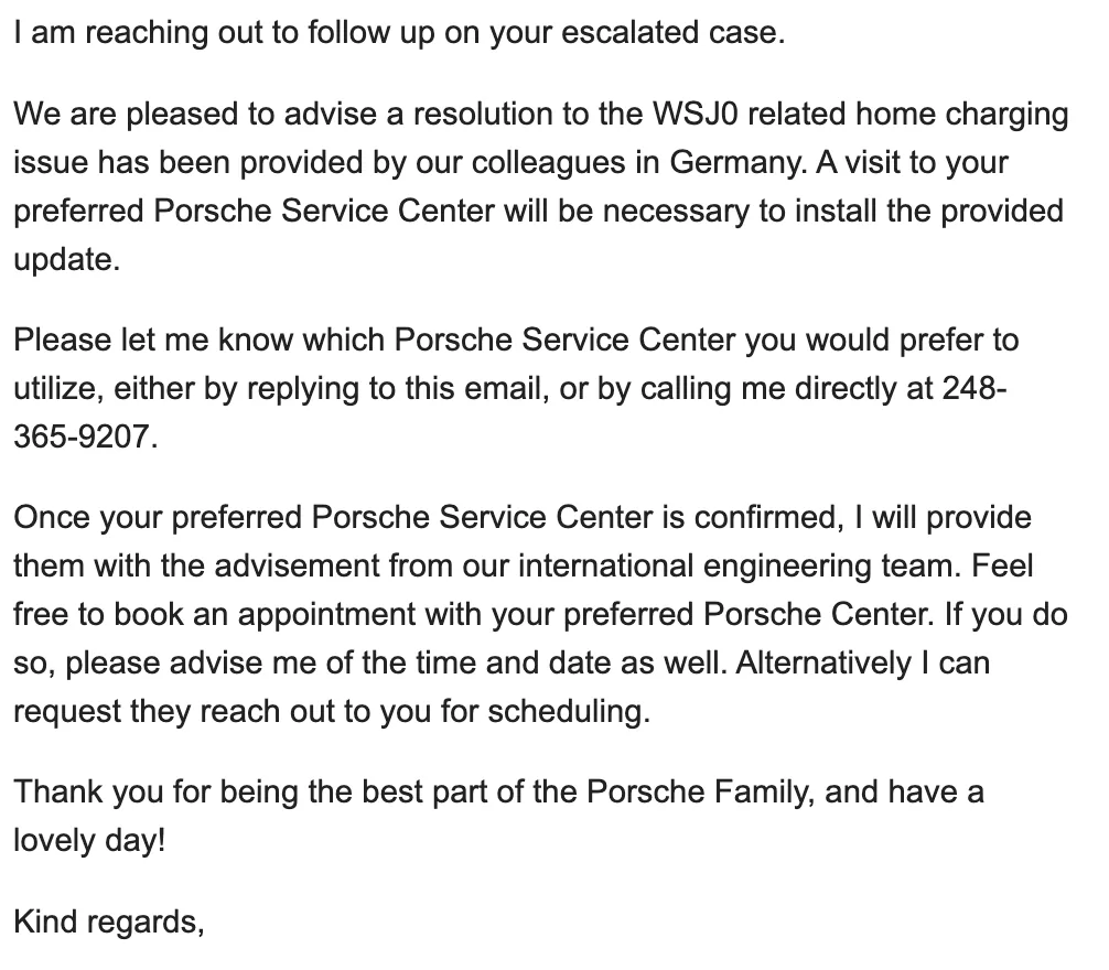

Is this update USA/Canada only or also for Europe?
toontoon
Addhyan
Apr 18, 2025
Chicago
Unsure about it. I am attaching the email I got. Feel free to call Jacob (he is Porsche NA's Connect and Charging Expert). I will direct message you his direct line phone number.
