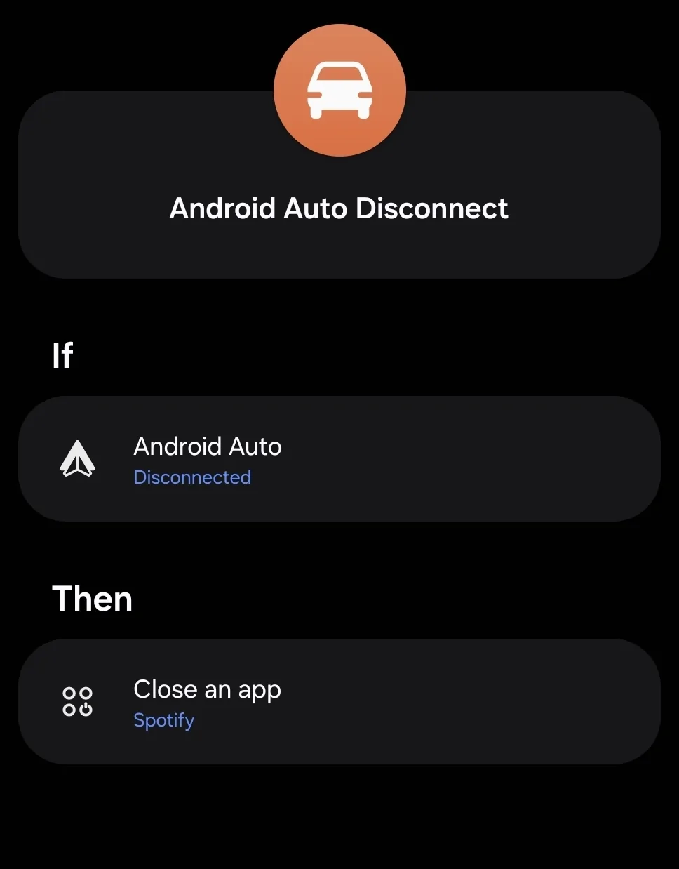

For #2, Here's how I "fixed" it: I have a samsung phone and created a Samsung Routine which detects when Android Auto disconnects and simply closes my music app (spotify in my case). It's worked great and I haven't had any surprise phone music in a long time. If you have a samsung, you can try it, not sure if other brands have a similar feature.

Start this with thanks to you guys for this level of reply. Pretty impressive.
I have a Pixel 9 Pro Fold. Not sure it has the same ability as what you described with your Samsung.
