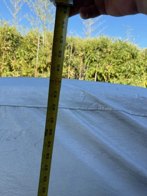

This is what 22" wheels and Normal ride height looks like.
I wouldn't count on the height level always staying low but if you can verify that smaller wheels at normal height is less the 64", you'll be in good shape.
