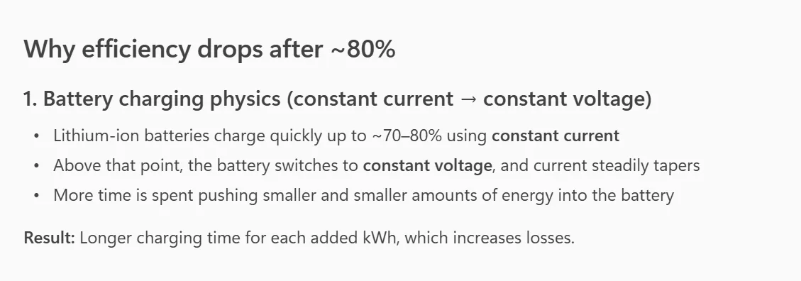

Yes, there is more energy loss past 80%. Using parking lot analogy, when parking lot is 80% full, electrons take more time and energy to find a spot. There is no point of charging past 80% unless you really need it for a long trip and you start using up that energy right away as best practice.
Electric Macan EV AC charging past 80% energy waste ?! 1775667685925-vk
380
374
Technically, correct. However, the ~10kw max from AC doesn't get limited by the charging curve of the Macan until about 97% (it's hard to read on the charge curve charts). Until that point, the car can handle as much as you can send at ~10kw.
So in practice, there is no slowdown or extra losses until you're above 95%. The last few percent may take a little longer as the car backs off the power demand.
